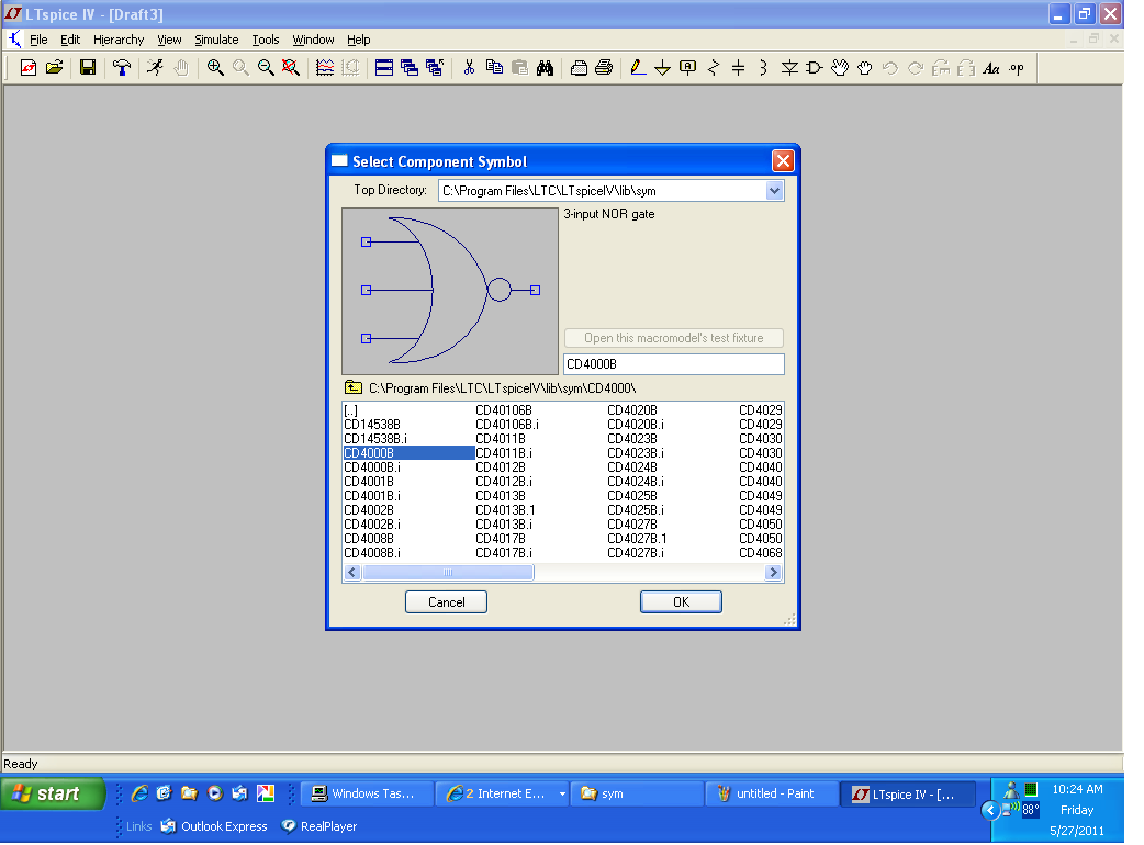

When you press F2, you should see 'CDlogic' listed in the window that pops up.
Double Left click it, a window should appear with all the CD devices listed.
Find the CD40106B in the listing [ note the numbers are not sequential]
Left click and OK, place the symbol on your circuit.
Type in .include cd4000.lib on your circuit.
This should now give you the ability to run the sim, when the circuit is complete.
Lets know what happens, if you wish post the asc file thats giving the problem

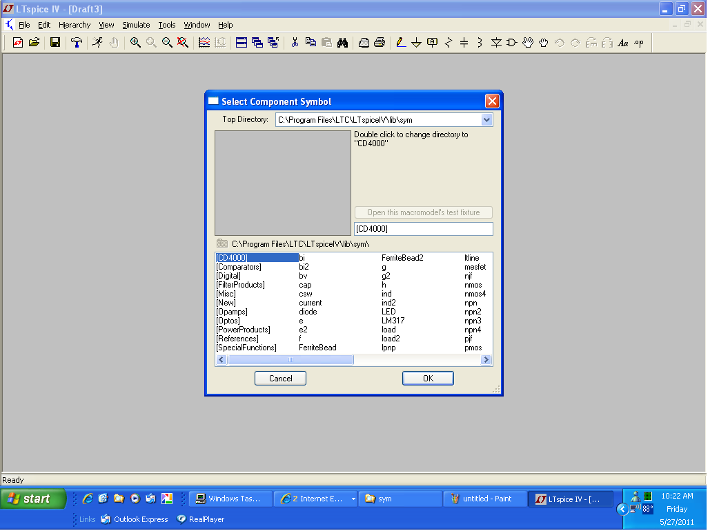

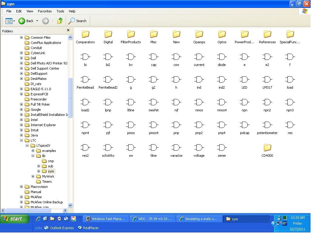

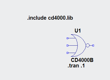

I don't know why I have so much trouble with this, but I do.:eek:

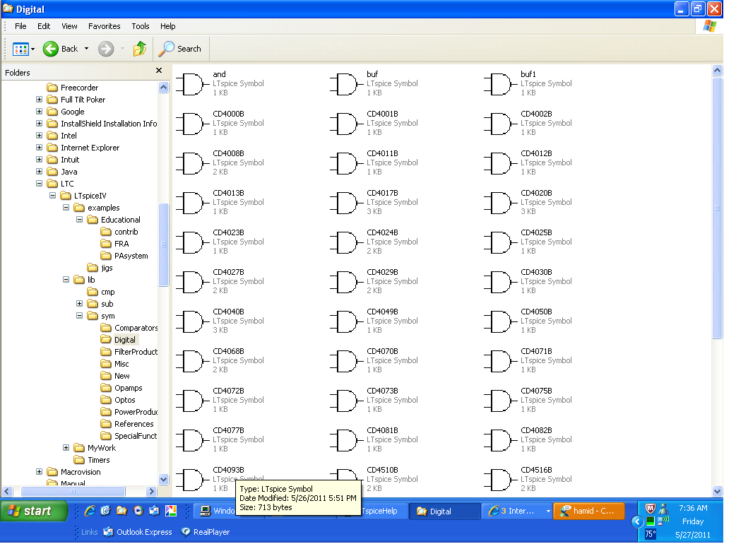

Here is what I did: Uzipped your files and copied them to LT Spice under symbols. Picture 1.
They show up fine in the main menu. Pic. 2 and the next step toward installing one in a schematic (Pic.3)
So far all looks normal and good.
Continued next post

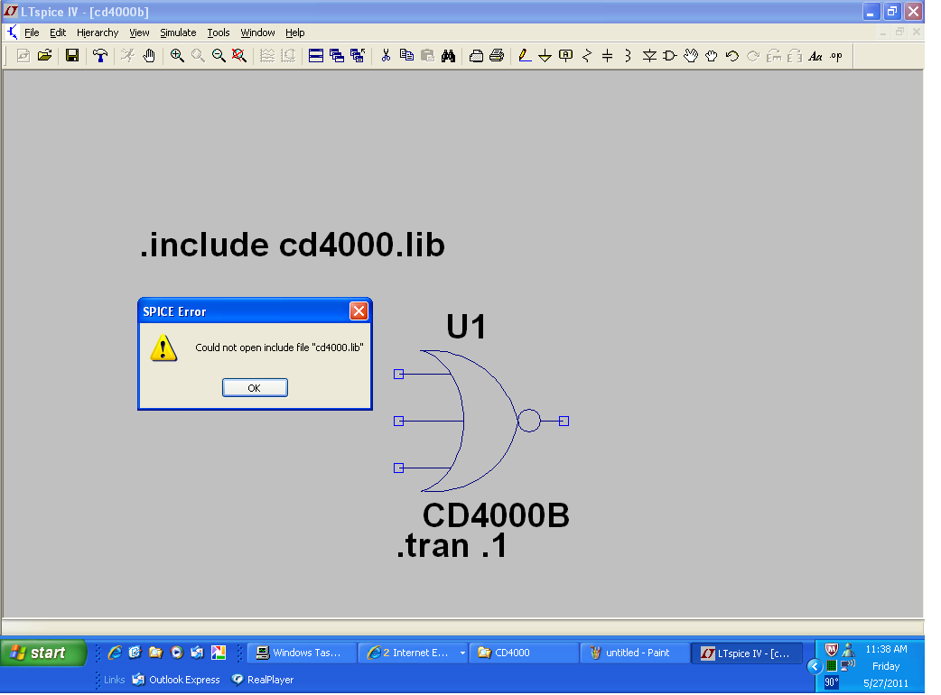

spice cont.
It goes in the schematic ok, but when I use the include statement I get the can't find message (picture) This is the same if I change it to include .sym or .sub or .asy.
Also attached is the asc. file.
  • cd4000b.asc

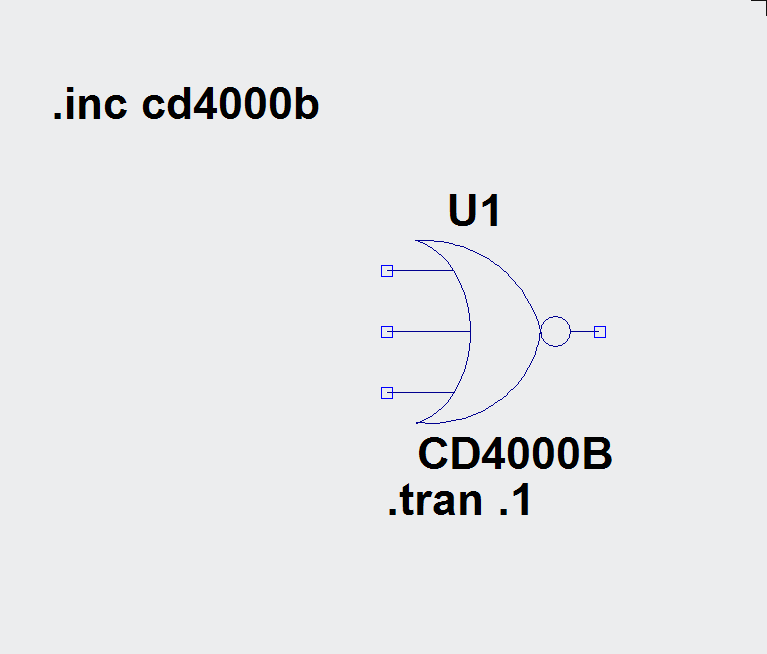

hi Ron,
When I open your asc file , I see this, it says .inc cd4000b
EDIT:
If I edit to correct it, it runs OK.
  • cd4000b(1).asc

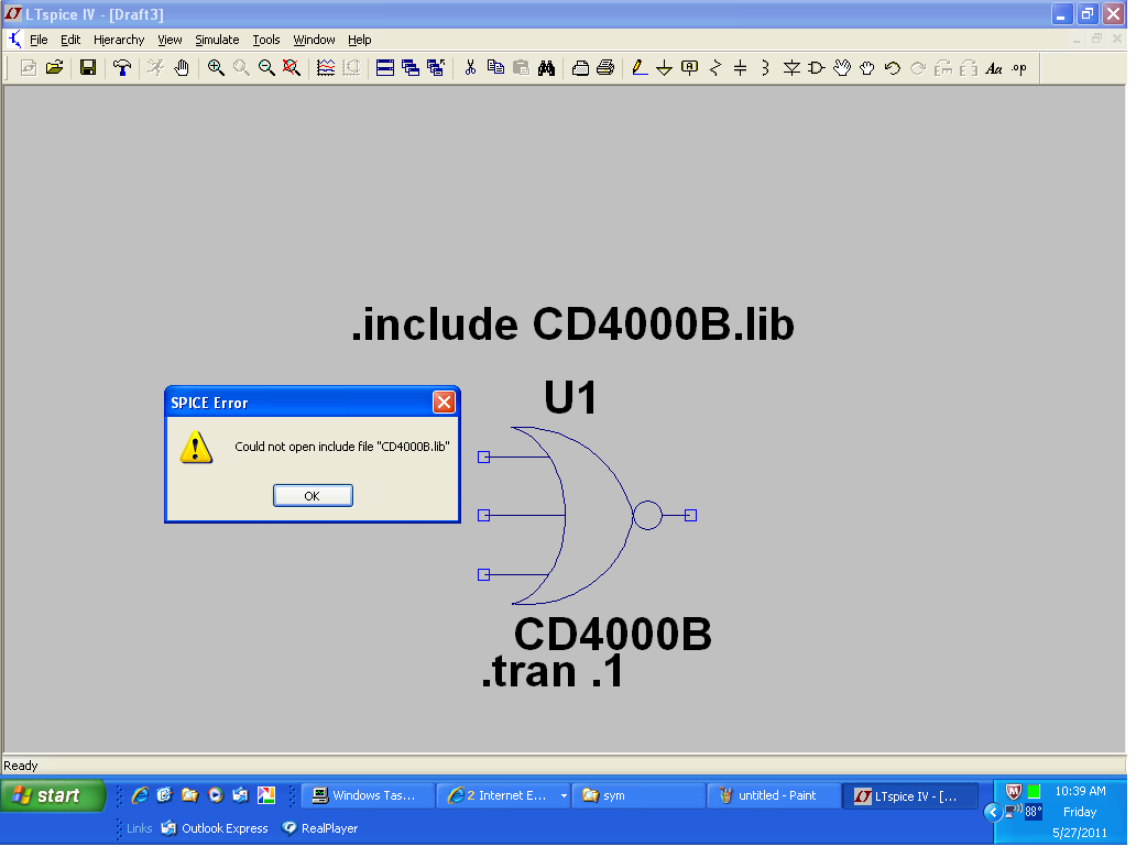

spice
Same o.
So I must have saved it with a bad file extension or in the wrong directory?
The CD4000.lib should be in the 'sub' folder.
See my last post.
Hmmm. When I unzip the file the name is CD4000 - no extension. So I renamed it CD4000.lib. Copied it to the sub folder of spice & deleted the cd4000 file from the sym folder in spice. Now no picture of the component to put in the schematic.
Put CD4000.lib in both folders (sub & sym) now it can't find CD4000.lib

In looking at your folders I notice 2 files that look like they have something to do with the 4000 family
1- CDLOGIC in your .sym file
2- CD4000.Lib in your sub file
I only have one. Is that my problem?
PS. You are always here! Thanks for the efforts!
