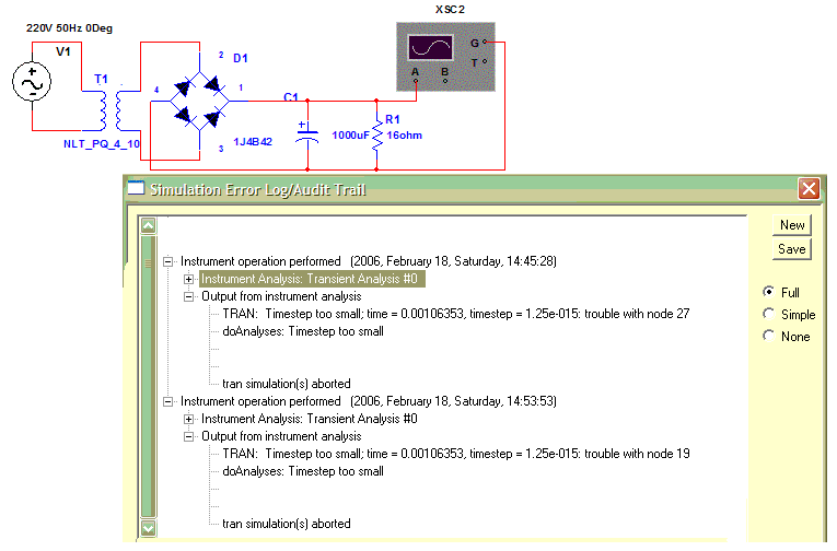

thanks ron for your help the mono is working now but i've got another problem. i'm trying to power the timer circuit form the same AC mains as the circuit it is triggering. it worked fine when powered by a reperate DC source but when i try to use a rectified voltage to power it, i get errors so i tried to create a power pack reperately and kept gettig errors the moment i put a load across the filter capacitor. i've checked the Inverse volatage of the diodes and everthing i know how but i doesn't seam to work. the ciruit is was built using multisim so if anyone here knows how to use multisim could you please help me out?
i've included the shematic and the error message i encountered.

I think most versions of Spice need a ground symbol, although you virtual scope may provide that. As I said, I have no experience with Multisim. Try it and see if it helps.
