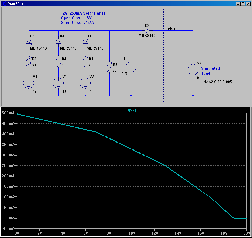

can anyone help me how to simulate LTC3401 and or LT1307 using multisim?

i have LTspice IV from linear technology and it can simulate those components but it will be very difficult using this software to simulate my circuit..

I dont know mike, maybe i just am not familiar with it.. my circuit contains solar cell and pilot cell.. i have to change it to electrical model,, it requires current source or controlled voltage and i cant find it in this software.,.

Au Contraire, LTSpice makes it very easy to simulate Solar Panels.
Here is something that matches pretty close to a panel I own...
