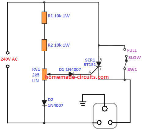

ps. If you are looking for a motor speed controller, a thyristor based one can be quite effective, if an appropriate circuit is used.
The links below are examples - an absolute minimal, crude version and a slightly more sophisticated one.
Again, these are not voltage regulators; they work from the motor back EMF, which is proportional to its speed. They only work with "universal" (brushed AC) motors as in typical AC power tools etc.
The thyristor must be a "sensitive gate" type.

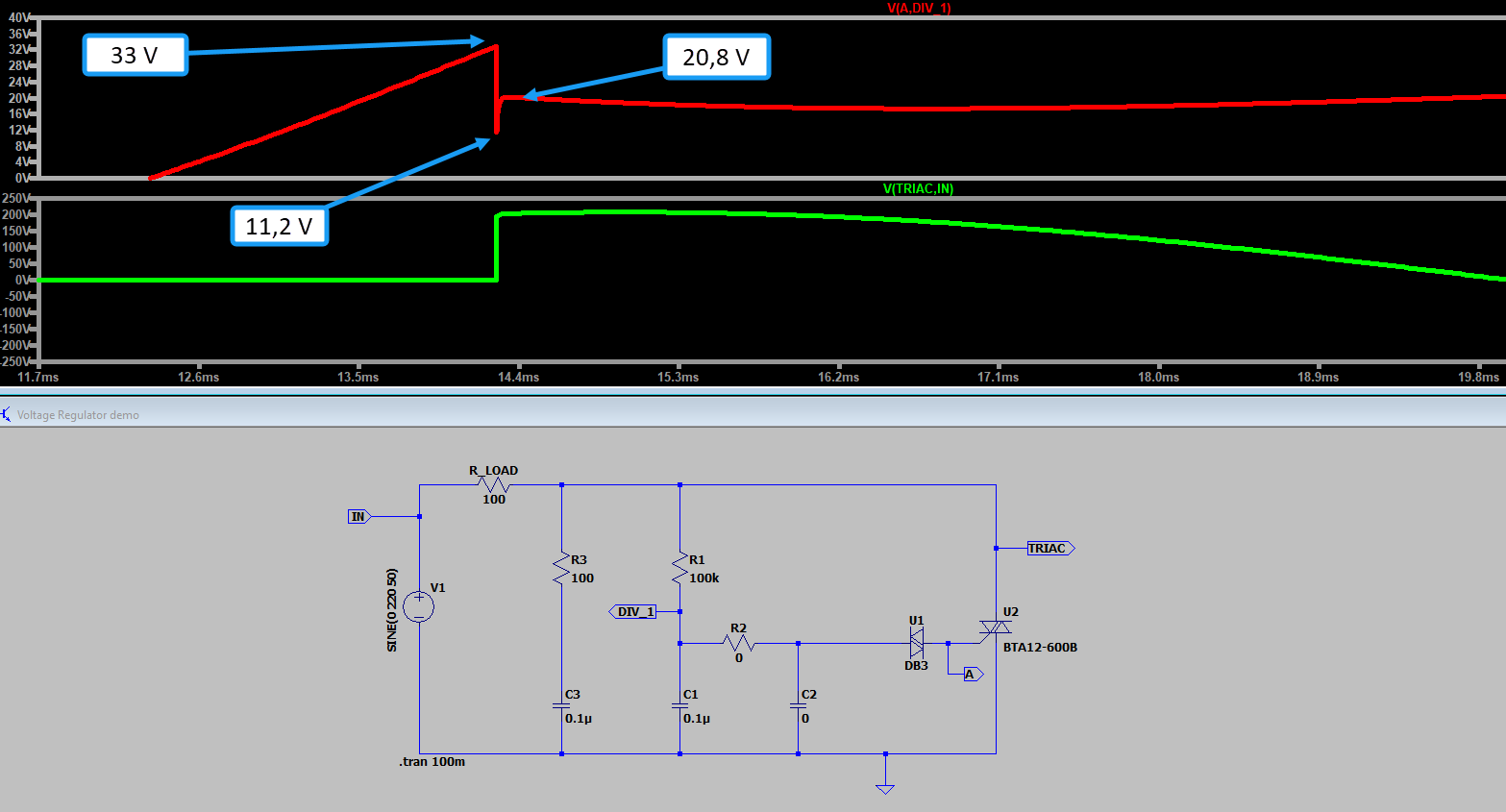

Great, I already found a already prepared for LT Spice schematic and try it. Also there was an issue with Diac library, I found a solution.
Here how it looks like:
I would say that values in Yellow circles not much applied for results, so I minimized it.

Btw, when I inspect most of this circuits variation, I have found that acros DIAC is voltage drop form 32 to 14 V.
From Where this 14V comes from?
My closest assumtion is that according datasheet it related to the delta V, and it's minium 5V (in mhy case it's32 - 14,3).
I notice that your AC voltage source is set to 220 Volts. Be aware that the voltage setting for a sine wave in LTspice is for the peak voltage.
If you want your simulation to run at the RMS voltage, you need to multiply the desired RMS value by 1.414.
