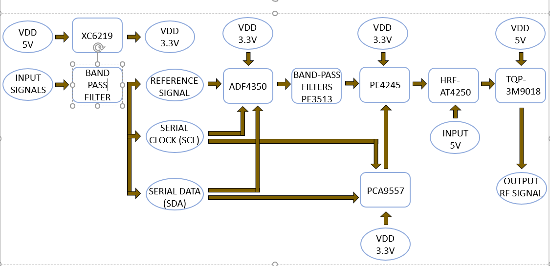

additionallt, i have three more chips if anybody here has time to help! TQP3M9018 , PE4245, HRF- AT4520. is tqp3m9018 basically just a gain amplifier that amplifies signal? hrf1t4520 is just to attenuate the signal to higher levels?(which is the same thing?) and pe4245 is the last on the schematic. sadly the schematic is confidential but i have attached the general block diagram for anybody who is interested.
Yes.
It's a programmable attenuator. It doesn't raise the signal to higher levels: rather, it reduces it by a selected amount.
