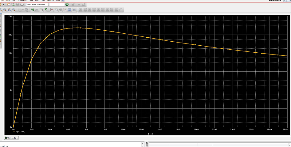

Hello MikeMI I took your file, simulated and it works well but I would like to understand why if I make a .dc simulation I1 ,the voltage that I visualize is not the voltage in steady state : it seems to be the initial voltage at time 0 , which is embarrasing. I join you file with my .dc simulation (it has index 2)
The model uses RC networks and time-dependent sources to simulate heat flow and thermal mass. It doesn't work for a .DC analysis? It seems to use only the initial calculated resistance...

Could you post the results that you get with PSpice? I am puzzled about this, and would like to see if there is a difference?
of course :but i 'm forced to copy paste as jpg won't upload : this is the voltage in f(I1) in PSPICE DC sweep. You see that the voltage is linearily increasing with current but then saturates and decreases.
I want to see the control statements that caused PSpice to make this plot.
I assume that the x-axis of the plot is the magnitude of the current source?
I assume that the y-axis of the plot is the final voltage across the thermistor after it self heats
I assume that the ambient temperature defaults to 25degC?

- it's the voltage across the thermistor (but by no means there is a possibility to choose anything about the conditions: it's just a probe just like LT). the simulation settings are exactly the same in LT than in Orcad. The only difference is that in Pspice, if you don't add a fixed resistor in// on the current source, it won't simulate. I added this // fixed resistor in LT but it doesn't change anything.
- by default the ambient temperature is 27°C (which will be the initial temp condition of the NTC)
It seems that in Pspice the computations are done in steady state WITH self heating , that is extrapolation for time infinite : it seems a natural computation.......
I'm very interested to unterstand this as I would like to publish the NTC models in LT as it's very successfull nowadays. Maybe there is a feature in LT to specify that you have to force the results to be extrapolated at time infinite.
