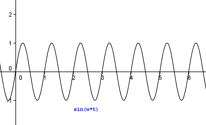

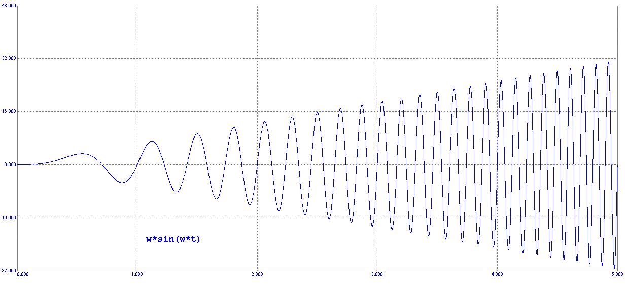

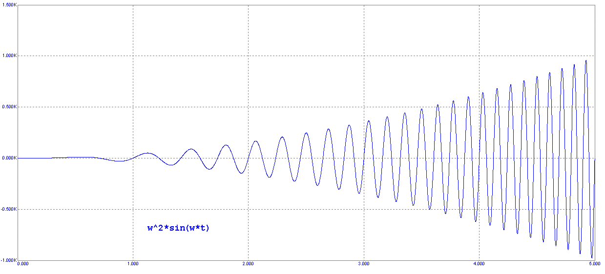

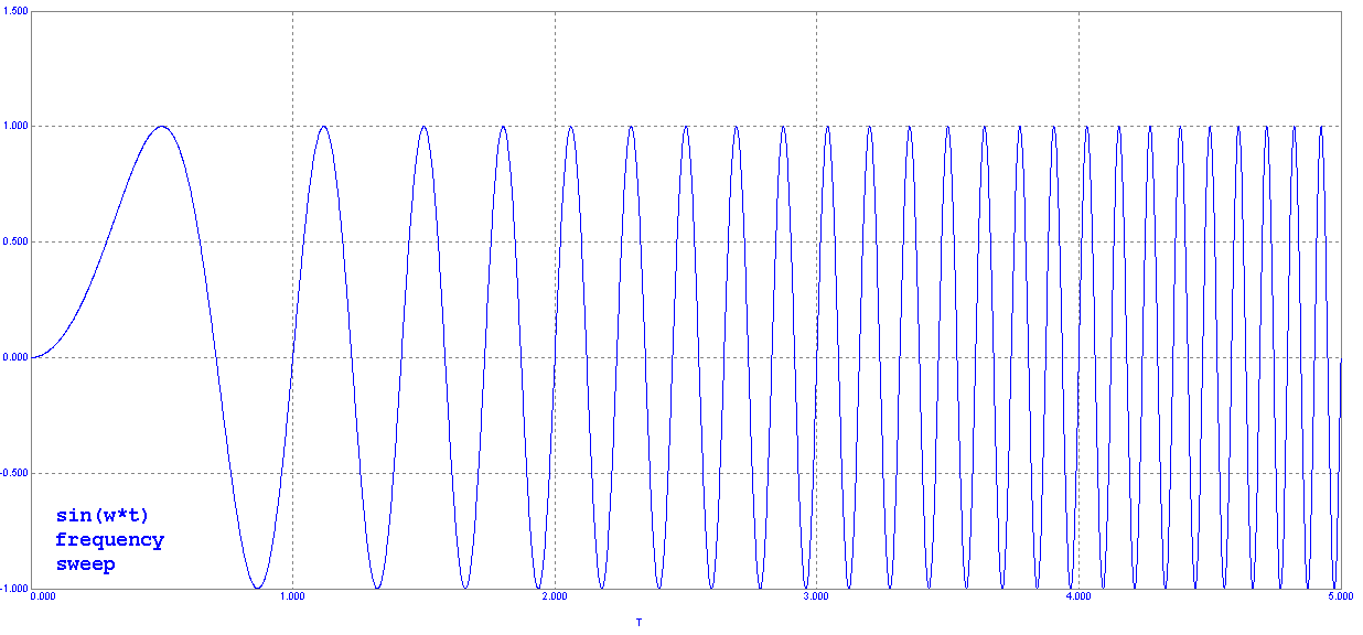

Hi drpower,
Here are four frequency sweep plots. One is for sin(w*t), another for w*sin(w*t), and another for w^2*sin(w*t).
We allow w to increase as well as time t for all but the first plot.
As you can see, sin(w*t) is just the sine wave.
w*sin(w*t) means that as we let the frequency w increase, the amplitude also increases. The amplitude increases as a ramp.
w^2*sin(w*t) means that as we let frequency increase, the amplitude increases again, but this time it increases much faster than with just w*sin(w*t).
So the w or w^2 makes the sin(w*t) look like it got a special kind of high pass filtering where frequency amplitudes increase either as w or as w^2.
The last plot (sin(w*t) with frequency sweep) shows the sine just being swept through some frequencies. You can see there that although the frequency changes the amplitude remains constant. Compare to the 2nd and 3rd drawings, where the amplitude changes markedly.

Hello MrAl,
Thank you very much for your reply,
So it says that by incarsing the frequncey of the function, the amplitude or the gain would be incarse too. Is that happen in a liner scale regarding to "w*sin(wt)"?
your plots make sense, but yet I am not able to see how "w" behinds the sine function (the first "w") affects on the function? Any mathematic/numerical explanation plz? Furthermore I do not know how/Why the said first "w"does affect on the MAGNETUDE of the sine function (w does not have the unite as the magnetude (ie voltage))?
So for Vm=1V in the first normal sine plot, the magnetude is able to cover more than 30V for "w*sin(wt)" and more than 900V for w²*sin(wt).!
I have to take you through PM regarding to this, So that I notice how it does happen in Nonliner air!!!!
As I told if you plz kindly could give me a mathematic or at least an example by the numerical values it would be very ok to completely understand it.
By considering w and w^2 as a high pass filter can you plz let me know if they obey the 3dB or 6dB/octave as normall high pass filters too?
