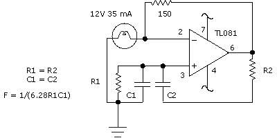

I have used the attached circuit from below 500hz to over 20 Khz.
I have found that if you replace either R1 or R2 with a combination of a potentiometer and a fixed resistor equal to or near the value of R1 the frequency can be varied about 10%, and if both R1 and R2 are replaced
with a dual pot the variation in frequency to really great. The only disadvantages that I have found are that it requires a split supply and it takes a few cycles for the frequency to stabilize after changing frequency.
For a different lamp the 150 ohm resistor may need to be changed to ensure a sinewave.
