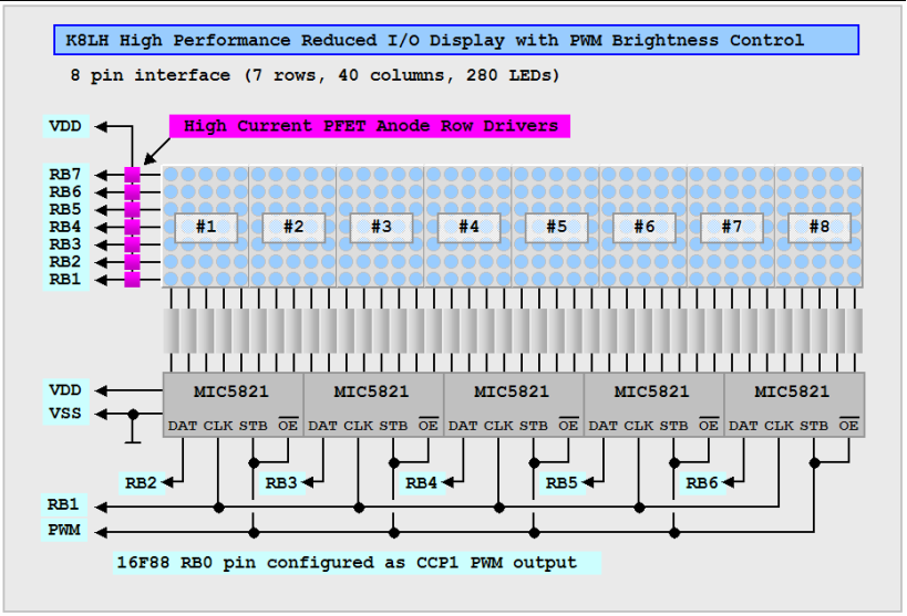

I got a super LED these days red colour ones which requires very limit current to operate unlike other ordinary red colour LED’s.
I’m making my own LED matrix board these days on the VERO board. I’m Very tired.
It consists of plenty LED’s as soon as I finish I will show you.
Still the column driver is a problem for me. At the moment I’m doing it with 4017.
It requires additional 10 transistors too.
I’m thinking whether to shift to ULN series or another type of driver IC to drive my columns which has the same RESET & CLOCK pins as 4017.

you might want to consider using a ULN2803 in place of discrete transistors, and sacrificing the extra bits on the 4017, so you can match up 8 and 8. Also take a look at the Allegro A6841 - it is a shift register and a high power current sink rolled into one.
i tried using the 4017 in a 24 led matrix, I tied the 4017's clock line to the latch clock for of a 595 register I was using as the row driver. each time I latched new data to the row driver, the 4017 would activate the next column, resetting when it reached column 4. problem is, I didn't bring the reset line to the microcontroller (ran out of pins), so the 4017 would start up in random states, there was also no way to 'skip' a column if I needed to. I switched to using a 74HC139 2 to 4 decoder so I can choose which of the 3 columns are active. danger here is a software malfunction could result in multiple columns being active at the same time, possibly burning out the row driver.

Hi JustDIY thanks for your information.
That’s what I wondering the ULN series.
ULN 2803 is an OCTAL driver is there any DECADE driver in the ULN series (Ten Outputs)?
Because I must avoid using four IC drivers instead of three. I have 30 columns.
I must bare the column drivers from three IC’s with minimum components.
The 4017 works well for me but it requires additional 10 transistors + 10 resistors.

How are you doing it now with 3 ICs? What 3 ICs? A '4017 and what other 2 ICs? What matrix configuration, 30 by what?

hows about just adding two more columns, then you have a 32 bit wide matrix - use two 16 bit drivers and you've saved a chip (from 3 to 2)
I couldn't find the micrel/allegro part, but TI has a 16 bit serial load parallel out register:
https://focus.ti.com/docs/prod/folders/print/sn74ls673.html
https://www.electro-tech-online.com/custompdfs/2007/06/sdls195.pdf
the parts are still listed as "active" but the datasheet is dated 1985, no free samples either :(
you could go with something like an i2c bus device, maxim makes lots of led driver chips with 16 or more outputs.

Gayan Soyza said:
All three IC's are 4017.4017 x 3 = 30 outputs.
Matrix Size 30 x 7 I'm using 7 bits from PORTB.
A 3 chip solution (no transistors) for a 30 x 7 matrix is certainly a challenge. I hope you don't rule out the Micrel MIC5821 or Allegro A6821 though.
