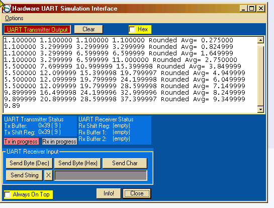

I am using a single data type variable to take a running average of four numbers. I made this really simple so I could verify that it is doing what it is supposed to do, but I find it doesn't do what I think it should.
Here's the code:

And here is a list of the averages it gives:
0.275000 - correct
0.824999 - incorrect. should be 0.285
1.649999 - incorrect. should be 1.65
2.750000 - correct. weird
3.849999 - incorrect. should be 3.85
the rest are incorrect from here out following the same behavior of x.xx9999.
Is there some setting I need to change or is this just a function of the single precision data type? I don't believe there is a round command in the basic compiler, so is there a simple way to fix this?
hi Mity,
This is your program on my PC, I have used the IDE Uart to show a printed record of the 'sums'.
I have noticed these rounding errors when calculating GPS data angles etc.
Eric.
BTW: I have spent ages on the SD card trying to get some of the commands working in a reliable way, looking forward to seeing your latest SD prog.

Mity, what you are seeing is the "single" precision accuracy, which is 6 to 7 digits (mostly 7). That is what causes the "9999" types of answers (I assume the 0.824999 you really mean 0.284999). This is a common error in any single float, it cannot guarantee the last digit, it could be +/- 1 digit. You can trim this with some form or "rounding", but I don't see that function in this compiler...
Using float (single) variables with 7 digit precision will always have +/- 1 digit error for the last digit. IEEE 754 standard clearly states "This gives from 6 to 9 significant digits", meaning you can only be 100% sure of the first 6.
I did a complex breakdown of floating point format some time ago!!! It's a very weird way of representing a number but there isn't anything better....
Oshonsoft does have the DECIMAL_PLACES directive but I don't know whether it rounds up or down ( I would have thought down )
In a single there will be 24 mantissa bits and unless the decimal fraction is weighted to a "achievable" bit there will always be re-occurring 3's, 6's and 9's.... In fact any number that doesn't divide into 10 so unless the last digit resolves to a 1,2 or 5... trouble... The though behind it.
2.499999 is only 0.000001 in error so who gives a jot!!
The mantissa fractions divide down bit by bit, each bit is weighted so:-
0.5, 0.25, 0.125, 0.0625, 0.03125... etc... so there WILL be numbers that will be out of reach
I understand, from the big picture kind of perspective, how this single precision stuff works, but these numbers are all well within the 7 significant digit representation. The compiler, for whatever reason, rounds everything down, so that 0.284999 comes to be 0.284 when the decimal places is set to 3. That makes no sense to me whatsoever, but it is what it is.

The compiler does not round down, but truncates the number, when displayed.
It can be handled, for example to display three decimal places, add 0.0005 to the number before displaying it.
