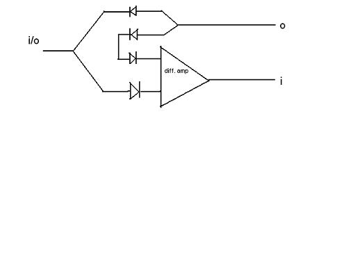

I want to build a circuit that uses a single electrode that can act as both an input and an output.
I have attached diagram of my first guess of how to do this.
Do you think this would work? I'm a newbie, so be nice ;)

What will the analog signals be used for? What is generating them? This is something for machine AI?
The goal of any neural network is ultimately machine AI, so I suppose mine is no different.
The analog signals could be any type of sensor input, for example the signal for one electrode could be from a single pixel of a CCD array.
What are you using as a voltage reference?

What I want to know is:
can a single electrode be used for signals going into and coming out of an analog signal processor?
If so, what circuit could be used to achieve this? (the one constraint is: I don't want the output signal going straight back into the input).​
If the answer is "yes, it's possible", I can move onto to considering other elements of the project. If the answer is "no, it's impossible", that's fine, I can reassess the feasibility of the project.
I don't understand how the "circuits of the nodes", "how complicated is each node going to be" and "how many were you thinking of" is significant to answering the question.
To help visualize the problem, let's say the voltage at the electrode, input and output are all within the range from 0 to 5V.
a conceptually very simple way of achieving input and output on the same line is to not them at the same time, but seperate the functions in time.
Each side has an accurate clock and before hand you decide that on every odd second side 1 will use the line for output and side 2 for input, on every even second you switch the functions.
Works great in the digital domain, don't know how well it would work for analog signals.
If you're hellbent on analog signals then in theory (i don't know if this will actually work) you may be able to get simultaneous input and output use by instead having the I/O tied to ground by a precision pull down resistor. Then either side signals its output by injecting a precision current into the I/O line. The line will rise in voltage (due to the precision resistor) to a level proportional to the incomming current. The other side detects this voltage and puts the signal into its own circuit accordingly.
If both sides are outputting and injecting current then the voltage will be proportional to the sum of both currents. Since each side "knows" how much current its injecting, it can subtract its own signal from this total signal and therefore get the signal from the other side without its own signal interferring. in theory you avoid feedback this way.
I don't know if this will actually work. Sounds good in theory, but you might run in practical problems with oscilations and such. i think the limited bandwidth of op-amps might prevent your system from using the higher frequencies, especially if it gets really large.
Noise might also be an issue, but if you really are in AI design then you might be able to chock it up to stochastic resonance.
