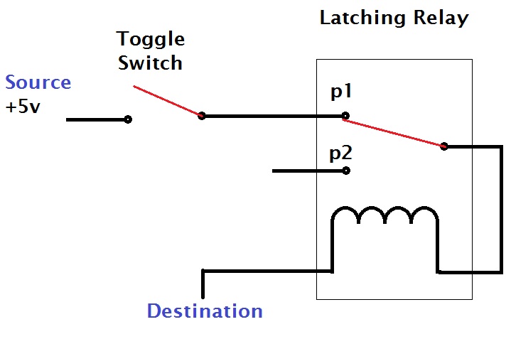

I'm working on a circuit, and run into a snag. Here's what I want to do:
- User Flips Toggle Switch to On position (Locks there)
- Single pulse makes it to destination
The obvious problem I'm running into is that flipping the toggle to on creates a continuous connection. The only way I can think of to prevent this is by using a latching relay which breaks the connection when the coil is energized (When the toggle goes to on) Which I very crudely illustrated in the attached JPG.
Does anyone know of an easier method of doing this?
Thanks in advance for any help.

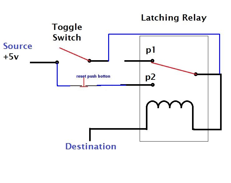

from your title i understand that you need the relay to latch continuously when the switch is pressed & released. see the attached diagram, hope it will full fill your requirement. you should have another reset push button or have to disconnect power to the relay to reset it.

Sorry, thats just my bad explanation. I'm actually looking for nearly the exact opposite.
I'd like it to allow a single pulse to pass (Given my original diagram, I was assuming that the amount of time it took to energize the relay's coil would suffice to connect the circuit from Source -> Destination) and then for the latching relay to break the circuit.
The reason I need it to do this, is I want to replace a key on a keyboard, so I need a single pulse (Akin to pressing a key) and then nothing. If the circuit remains connected it will continually send the pressed key to the computer.

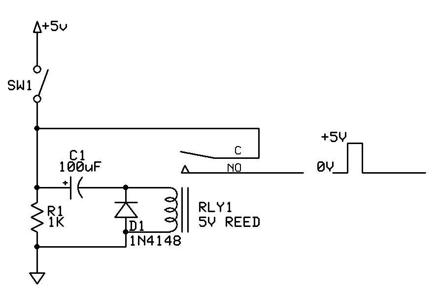

The attached is a relay pulse generator. The length of the +5V output pulse depends on the value of C1, the relay's coil resistance, and the relay's drop-out voltage. You get a brief pulse out when SW1 closes, and nothing when it opens. If we had a schematic of your keyboard, it could probably be done with an IC.
Ken
