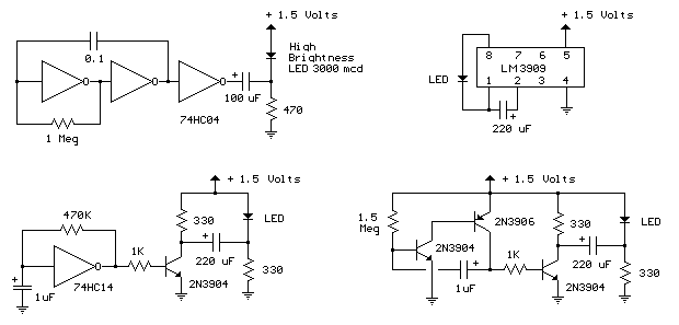

Waaaay back, National Semi produced the LM3909, which worked from a single alkaline cell. Unfortunately it is discontinued, but you may still goggle it and find some stock.
For an ultimate "single chip" solution, you may use a device from the PIC10F-series of microcontrollers. They do come in 6 pin SOT23 packages.
If you want a very simple and cheap solution, use a PIC16F84, add a crystal, two 22pF capacitors and a few lines of ASM.

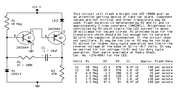

how a bout a UJT? Those can make a low speed low parts flasher.

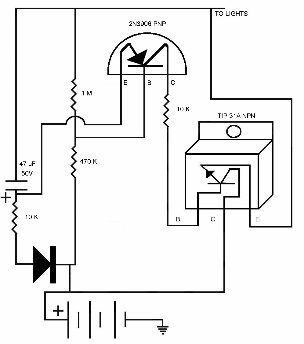

If you want to flash a high powered LED of incandescent lamp, just put the LED in series with a suitable resistor connect it to a transistor's base and connect it to +V.
I'll post a schematic if this isn't clear enough.
Transistors could do it too.
