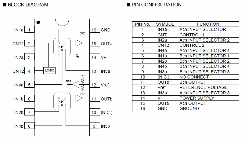

Hi, all
I would like to connect a 2-way radio to a fixed gooseneck mic and two speakers, with the option of using a headset. So the radio needs to be connected to both, but switch between the head set and the fixed equipment. I would like the entire switching to happen with a on-on toggle switch (STSP/DPST/nPST), so that it looks like all the other switches we use.
Sorry if this has been asked ad infinitum, but I have found a switch that does the opposite: switch between multiple inputs and send to a single output. It cannot be adapted to do what I require.
Thank you in advance
Unles I'm mistaken, **broken link removed**has diodes preventing signals going the wrong way. Please confirm for me that I can in fact use it.
That's what I thought.
I'm thinking flip flops will do the trick, but I'm not sure. Space and mass are at a premium, this is not a studio I'm building, it's an ultralight aircraft.
