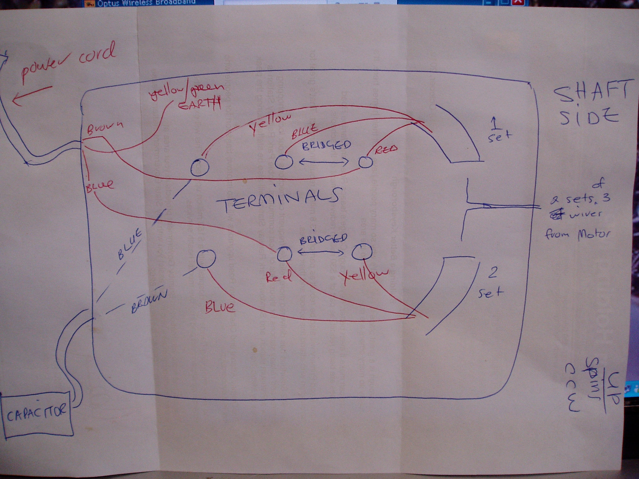

I'm trying to change the direction of my new single phase capacitor start 1hp AC motor.
The motor is for my air compressor, and currently rotates clock wise.
Please refer to my wiring diagram for this motor.
At this stage I havnt changed any wiring

Would anyone know how to rewire the circuit by looking at my diagram?
Thanks in advance
You need to remove both bridges, and rotate them 90 degrees and refit, so that top row red connects to bottom row yellow and bottom row red connects to top row blue. Leave the capacitor connections and the mains connections where they are. The must not be any bridges to the capacitor.
You've got a 3 phase motor, being run as a single phase motor, which is quite common. You can't get full power from it, but it's a perfectly good way of running a motor.
The red wires are one phase, the yellow the second, and the blue the third. They are normally wired with the three phases to one row of terminals. Then all three connections on the other row are bridged for Star connection, or each column is bridged for Delta connection. It is possible that you will find that there are 3 bridge connectors to allow for this.
It has been connected to power the red phase directly. The blue and yellow phases are in series, and in series with a capacitor, to give it an advanced phase that starts the motor running in one direction. By reversing just the starting winding (the blue - yellow - capacitor bit) then the motor will reverse.

I'm afraid that I have to disagree with Mike about there being a centrifugal switch. I don't think there is one, it's just a standard 3 phase motor.

That is a 3 phase motor run in open star connection which has better starting torque this way.
You can swap one bridge or wire pair over to change direction.
