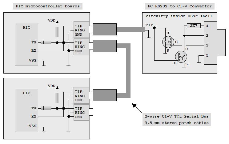

I have a MCU pin that toggles tetween 0-5v at fairly low speeds (<10khz) This pin is connected via open collector transistos so as not to affect the line when not is use, the line is pulled high (5v) extrenally and other MCU's are connected using same method. Data is then sent down this so the MCU's can talk
I want to have this method but also an "override method" so when my pin goes high the line it is kept high and cannot be pulled low by other MCU's and vice versa for low. This override methoed needs to be switchable (on/off)

With bipolar trnasistors you can prevent another transmitter from getting a message through. The other transmitter can do the same thing to you. Listen carefully. You cannot override the other transmitters signal unless it is passively pulled up. This signaling mechanism has nothing whatever to with RS-232 so quit bringing that term into the discussion, it is just confusing things.All the RS232 levels are same (TTL)
All devices are connected via bipolar transistors
my current circuit connects via bipolar transistors so as not to cause problems
I want to sometimes take control of the single wire and FORCE my Tx on it, ensuring nothing else on bus overrides it (don't forget they are connected via bipolar)
I'm sure this can be done as I have forced a low (holding wire to GND) and forced a HI holding wire to 5v, but I'm looking for a simple way if switching this on / off

Now it might be my terminology or lack of knowledge but all I know is if I stick the line direct to GND no data appears on the line and if I stick it to 5v supply again no data just flat 5v line. so it is possible to override the signals, how would I do this "forcing" in time with a pulse on a pin even if this some sort of power transistor, one for GND and one for 5v.

OK, there is an existing PCB with an existing working bus, using one line to TX/RX commands, this bus is "based" on the RS232 protocol in speed and timing only. the devices are connected to this bus using open collector transistors that I know for definite cannot withstand a pull up to 5v of just a few ma and I suspect (yet to check) a few tens on ma down to ground, I have tested the theory of what I want to do by simply placing the wire to +5v supply and GND in both cases all transmissions are blocked and after removing it comms continues without problem.
I want to mimic my manual placing to +5v supply and GND in time with my MCU pin thereby overriding any device talking on the bus and if a device is listening managing to get my command to it, after I issue my command I release the bus and listen for the reply.
