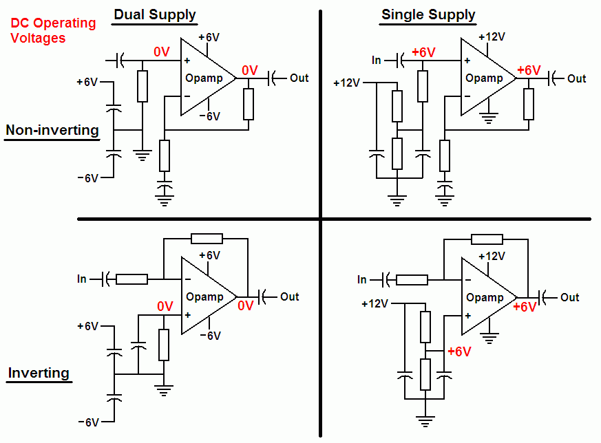

Any opamp will work amplifying AC signals if it is capacitor-coupled and uses a filtered half-supply-voltage divider as its voltage reference like this:

You can have a number of DC coupled opamp circuits in series with a single supply if you bias the non-inverting input of the 1st one to half the supply voltage with a resistor divider, then keep all levels within the input common-mode range of the opamps.
A comparator with a single supply can be DC coupled to the sine-wave and triangle-wave signals if they are biased properly and are also powered from the single supply.
