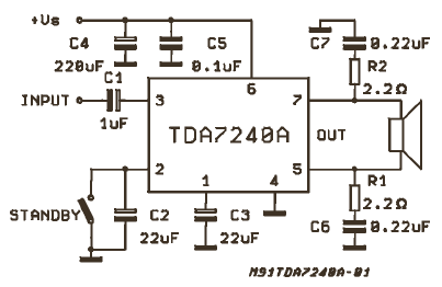

The LM1876 doesn't work very well as a bridged amplifier. Most bridged amplifiers have nearly 4 times as much power output when bridged because the voltage swing is doubled and the current is doubled. The LM1876 has only twice the power output when bridged but it gets 4 times as hot.
Here is a simple car amplifier IC that is bridged and has a single supply voltage. With a 14.4V supply its output power is 15W into 4 ohms at clipping:
