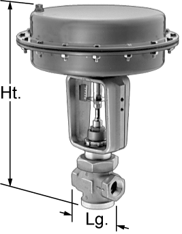

Attached are two images of different types of valves. The first is a basic on or off solenoid valve. This is the type both Carl and I mentioned using 3 of for slow, medium and fast. The second is a valve body that can be controlled for example from 0 to 100% open.
You have not mentioned yet how you plan to do the actual control? Do you plan to write some software for a micro controller PIC Chip or use a computer? Until anyone knows your plan it is difficult to answer questions or go much farther. I suggested a single sensor for level and Carl also made a suggestion and you never commented?

i planning to write some program for a microcontroller chip and use ur suggestion which a single pressure sensor and the valve body that can be controlled for example from 0 to 100% open in my project. is there any schematic and source code as reference?

In an effort to keep this simple here is what I would suggest. I would use a pressure sensor to measure the tank level. I mentioned that several post ago. Using a controlled valve though a nice way to go gets complex so to keep it simple I would do as has been suggested. I would use three simple On/Off solenoids and drive them from a PIC. This way you only need one ADC Input and three DO (Digital Out).
You need to determine the height of the tank in mm (for me inches). Then determine a suitable pressure gauge. The pressure is converted to a voltage proportional to the column of water.
