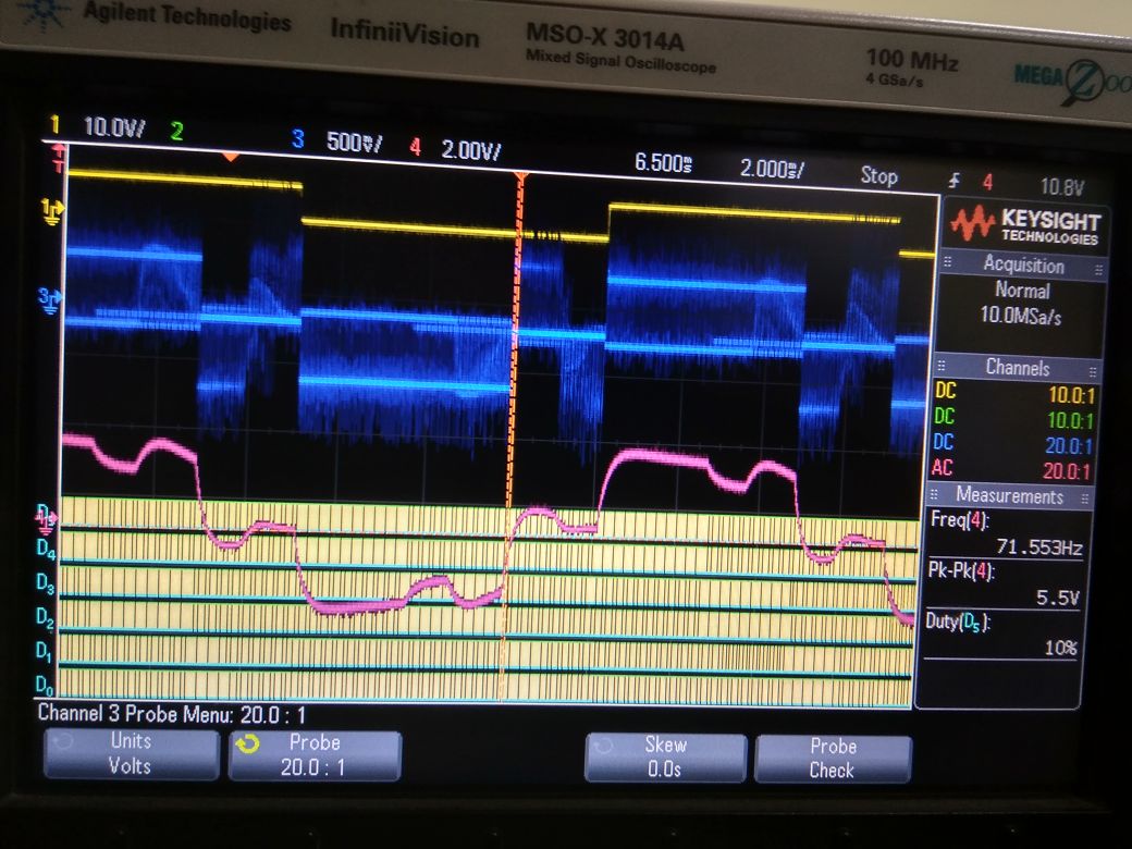

This is one of the results.

3. What is the blue and red waveform in your scope photo?
The blue and red photos are the filtered line voltages. I expected them to be sinusoidal.

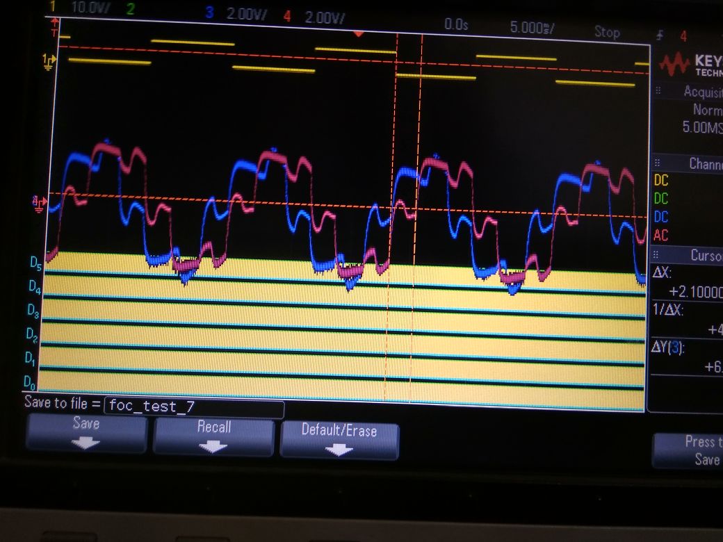

Is there a the filtering circuit between the driver and motor? What is the frequency of the "sinusoid" and what frequency is the PWM? Could you post a scope of your PWM waveform (the gate drive voltage) on top of the line voltage?
Did you build the entire circuit yourself or are you using a development board?
I have my own board. The filtering circuit was just added to see on the scope. The pwm frequency is 20khz. I did not measure the sine wave frequency. Do you think sine wave should be of particular frequency?
The sine-wave frequency will be decided by the rotation speed of the motor from the hall sensors. You don't get to pick the sine frequency without also changing the RPM. You need the PWM frequency to be higher than the rotational frequency by enough so that you can filter out all the square harmonics to get an approximate sine-wave (although I think the motor inductance can do that on its own in some cases as well).
Is blue your PWM gate drive signal? Zoom it on and it and look the duty cycle closely. From a distance, to me, it looks like your line voltages are doing what is expected of your gate drive voltage. But your gate drive voltage doesn't look like the duty cycle is varying sinusoidally which would explain the strange waveform. It should kind of look like this:
If you built your own board, make sure your gate drive is sufficient to turn your MOSFETs on and off fast enough.
