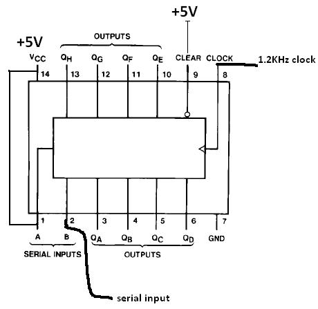

hi there,
recently I've been trying to use 74164 to obtain separated bits of a byte and I've connected this IC as the attachement shows.However I'm getting all ones on all of the output, even when I change the byte(serial input).
so could anyone help?please?
thx in advance.

The datasheet states that the 2 inputs are ANDed to provide the data to the SR. Either connect one of the inputs to Vcc, or connect both inputs together.
The results.....
Hi there,
I tried to join the two inputs A and B but the result is still the same: I'm getting either all zero outputs or all ones, eventhough I'm changing the byte value entered (considering same clock).
I also tried placing another IC just to make sure that the original is not burnt or something, but guess what: it's the same. Maybe it's an error in connection 'cause this is the first time I use this IC.
regards.:rolleyes:
how are you entering the 'byte value'? Once you've clocked in the 8 bits, you have to stop the clock or else all the bits will be shifted out again. When you want to shift in the next 8 bits, apply another 8 clock pulses in conjunction with the 'byte value'/

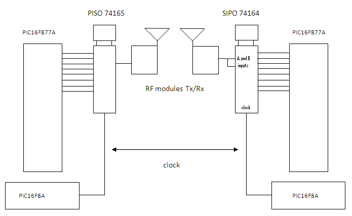

Well, what I've been doing up till now is to connect the byte in question- generated by DIP switch inputs connected to a shift register (74165 parallel in-serial out) driven by a clock generated by the 555 timer, to another shift register 74164 (serial in-parallel out) driven by the same clock.The clock's always connected like this, but doesn't that mean that the output of the 74164 will always correspond to the dissassembled byte? Otherwise When do I stop applying the clock?
Your advice on this please?
Thanks very much for any help.
regards.
Feel free to post your schematic of the circuit that you're using now.
With the parallel-in-serial-out (PISO) SR you need to load the data into the latches/SR by using a falling edge (a low pulse) on the parallel-load (/PE) pin. Then the 8 bits of data are shifted out using 8 clock pulses. if you apply any more clock pulses, then you will start shifting out unwanted values.
With the serial-in- parallel-out (SIPO) SR you can use the same clock and the output serial data from the PISO is fed into the serial input of the SIPO. With each of the 8 clock pulses, data will be shifted into the SIPO and displayed on its outputs. if you apply any more clock pulses, then you will start shifting in unwanted values.
So, pulse /PE low, apply 8 clocks. Repeat whenever you wish to update the output values.
Just so that you can see what's happening, slow down the 555 timer to maybe 1Hz and connect an LED to each of the '164 outputs. Apply some 'byte' pattern to the PISO parallel inputs, pulse /PE and see what happens at the LEDs.

what microcontroller? draw a diagram of what you're talking about.
Don't do it that way.
The pic16f877 has a "shift register" built in, also known as the USART, which allows you to transmit and receive serially and also puts framing in so that the receiver knows where it is up to. Or you can use a pin and bit-bang the incoming signal if you wished to use some transmission encoding scheme of some sort.

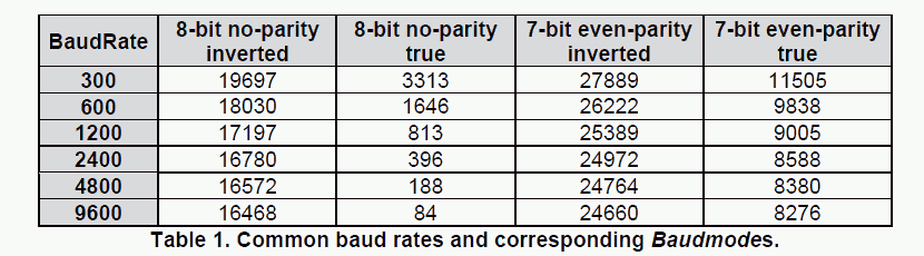

Please read the manual/user guide that came with your compiler. For the SERIN/SEROUT command, you need to specify the baudmode parameter (for which you have put 9600) to control how fast the bits are sent, their polarity and other properties. I've attached an excerpt from the manual that shows some example values for different baud-/bit-rates.

Thing is, I tried different baud modes but the result is the same: I'm not getting the result that I want, which is to securely send data and almost acurately receiving it; obviously the system needs some sort of a codec.
