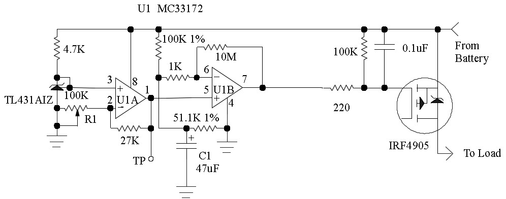

Would you mind sharing your IRF4905 circuit?

The attached diagram is for the battery disconnect circuit. The TP is for adjustment of the disconnect voltage, and it is very close to 1/3 of the applied voltage. The 47uF capacitor gives the circuit some stability in that if a load is connected to the battery the voltage my dip for an instant. This capacitor prevents the circuit from disconnecting the load in that condition.
Thanks.
