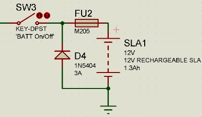

Hi there. I am working on a basic 12V SLA battery "float" charger for an emergency power backup application. Works fine and everything, except for one little thing that's bugging me (yet it's probably very simple, but can't for the life of me come up with a solution).
I need a small "add-on" circuit that will warn me (perhaps with an LED) when/if the battery is disconnected from the charger. Possible scenarios:- Battery connection becomes loose; the fuse blows due to a short or incorrect polarity; or the 'Battery On/Off' switch is "Off") - otherwise there is no way of telling that the battery is connected or not.
I have thought about using the battery's internal resistance as a detection method, but I'm not sure how I would go about this, and its reliability.
What needs to be taken into consideration is that the battery may or may not be drawing current from the battery. Therefore, a 'current flow detector' may not work in this case.
I have attached a diagram explaining how the switch, fuse and diode are connected to the battery at the moment.
Voltage applied to battery = 13.5-13.8V
Current supplied to battery = <0.39A.
Battery = 12V SLA, 1.3Ah.
Any help on this matter will be much appreciated. :)
Jason.

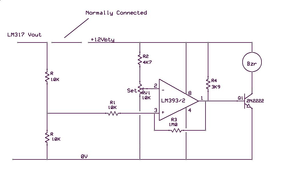

Something like this would get the job done.:)
EDIT:
You could use the second half of the LM393 to set up an additional 'low battery' alarm, connected across the battery.

Thanks for taking the time in drawing up the schematic, Eric. I can see your idea, however, with due respect, something tells me it's not going to work very well...
The "What If's" that come into my head are:
- what happens if the main power supply fails due to AC failure? The buzzer would sound due to the huge voltage difference, yeah? I don't want the buzzer/LED to come on during a power failure.
- how would the comparator work if the battery is not present? (as the comparator is powered off the battery).
Also, the "Normally Connected" bit in your schematic: Do you mean commonly connected/same power circuit, by this?

hi Jason.
What would be the point of any means of detection if the battery wasn't present.:confused:
It could be configured not sound if the mains failed, but that wouldnt give what you asked for... a battery disconnection.
But it would warn you that the battery isnt being float charged.

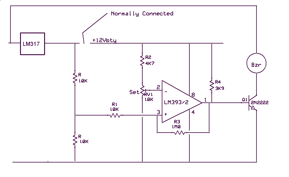

Not knowing the pre reg circuit, something like this change should be OK.
I would consider using the second half of the LM393 as I suggested, it will warn you when running on battery power, the battery is getting loooooow.!

Thanks for re-posting the schematic, as it confirms my understanding of what you meant about the positive lead of the buzzer/LED.
As with the Low Battery warning suggestion, yeah I could make use of that second half, but I already have a (2-phase) voltage monitor implemented into my design that even disconnects the load as soon as it drops to a certain voltage range ;)

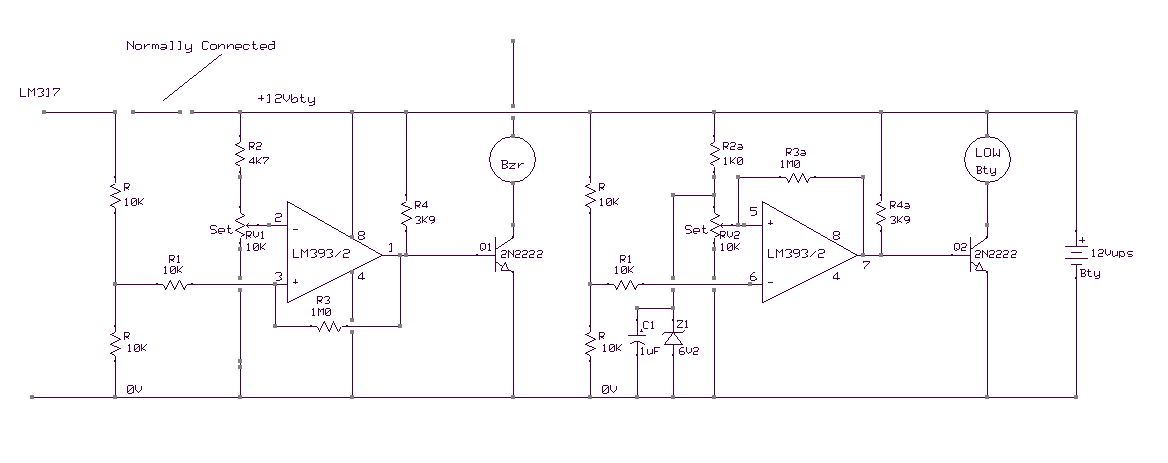

Updated circuit.

Hi Eric, I tested your circuit (not the second half though) and I can't get it to work properly. I am using an LM358 because I don't have an LM393/2, and I don't see much difference between the two anyway. I have tried all sorts of things. I even tried swapping the grounded 10K (for the potential divider) with an LM336 2.5V reference (as seen in various schematics) and overall I can only get the circuit to work as a Low Battery monitor, not as a "Check battery connection" monitor. :(
Also, what role does the R4 resistor play?

Hi there,
If you use LM358's instead then you should connect a 1k resistor (or more)
in series with the transistor base (one for each circuit). The LM358 can
source and sink current, while the LM393 needs a pullup (R4). R4 is the
pullup which isnt required with the LM358.
I am assuming that the connection is broken between the battery and the
LM317 ahead of this circuit, and that the battery, when disconnected,
is still connected to the LM358's. This might be a bit of a stretch as
we dont know if the battery is going to stay connected to the LM358's when
it's disconnected from the LM317.
An improvement might be to diode OR the battery AND the LM317 so that
no matter which one is alive it will still power the circuit. Only the buzzer
gets connected to the LM317 though.
The diode OR circuit would simply be two 1N4001 diodes connected with
cathodes together, and the two cathodes power both LM358's. The
two anodes go to both the 12v battery and the LM317, one anode to
each. This keeps the LM358's alive as long as either source is alive.
To make this even a little more reliable, you can provide a separate connection
for the LM358's to the battery, or even have a good quality back up battery
just in case BOTH power sources go down. The back up battery would be
wired through a third diode, cathode to LM358 supply pins and anode to the
back up battery positive (+) terminal.

hi jst.
I have some LM358's on the bench, I'll let you know the changes you have to make to the circuit.
BTW:
the LM393 or LM358 is powered from the battery under charge.
Only the top of the 10K [top left] is 'powered' by the direct output of LM317

hi Al,
The circuit has been tested using a LM393 and it works fine.
If he uses a LM358 all he has to do is remove R4 [3K9].
Again testing on the bench this morning using a LM358, the circuit works fine.
If you consider that all the OP wants to do is detect a 'poor' or open connection between the LM317 charge output and the battery on float charge and the float battery powers the OPA it worls OK.
I utilised the 2nd half of the LM393 as a simple float battery 'low' alarm.

the 1k resistors. You'd have to leave it run for a
good hour or two, then come back and feel the ic
chip to see how hot it got.
Repeat with 2.2k resistors on both outputs in series with
the base of each transistor. Compare the heating results.
Would be nice to hear about this test. It's a little hard
to simulate this kind of thing.
Thoughts?
