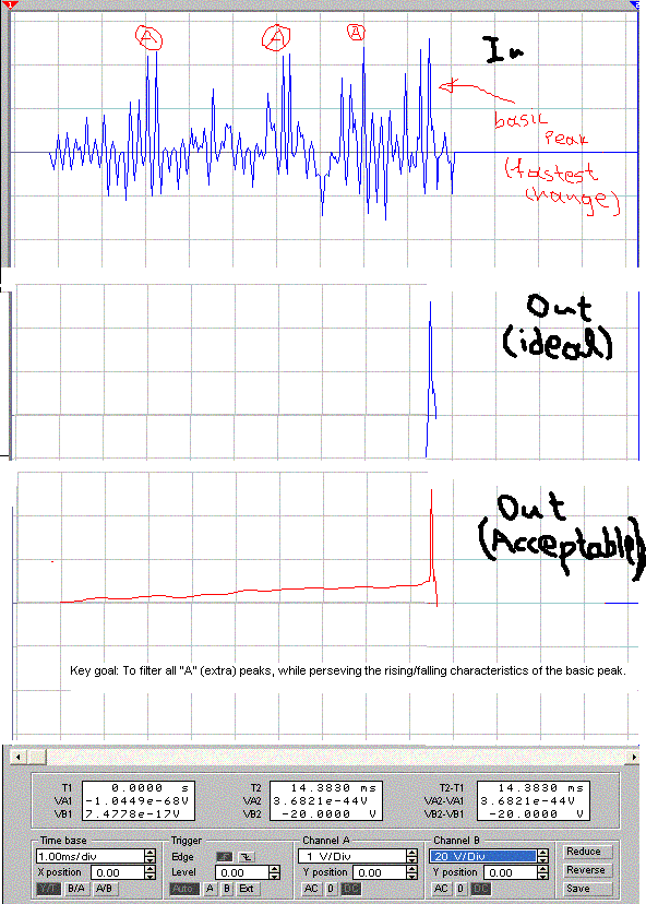

I tested the simplest of the schematics you suggested (pulse extracto1.gif), due to the fact that they are all based on the same principle (conducting diodes). Here is what I found.
(By the way, below you shall see a schematic of what I am trying to do..It has to something to do with detecting/filtering audio transients in a noisy background.)
The "pulse extractor" u suggested is actually a "limited" version of what I am trying to do to achieve the result depicted in the schematic..(likely the reason I forgot to reply..??..)
U see, it lets fast signals to pass through, yet it filters slow varying parts of the signal by making them quicker.
I don't want that..I want fast varying parts of the signal to pass unaltered, while slow (actually they are also fast but slower than a certain slew rate I can set) parts of the signal to be "smoothen out"..Does this make sense to you?

"...Regarding a maximum and minimum slew rate limiter: What exactly does a minimum slew rate limiter do? This conjures up a vision of a circuit that create a slope if none is present - sounds like a bad idea. :?
Min/max slew rate control I mentioned referred to the circuit's ability to pass only a certain "area" of rate of change unaltered.
The schematics proposed for instance, allow quick-varying parts of signal to pass through unaltered, filtering slow varying parts.
That implies that quicker than the initial quick signals that pass through would also pass through.
I would prefer if that would not happen.Perhaps by having the ability to set min/max rate of change (and perhaps by "narrowing" this "area" down too much it could pass only a specific rate of change....that would be awesome!) that can pass through untouched.
What'd u think?
xmat.

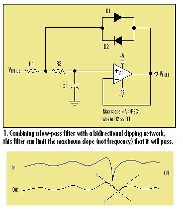

So, what with the statement below the picture..Is it false and in what sense?
Have you by any chance thought any solutions?
There must be a way to solve this problem and you were close....I don't even want to think about the potential of you not knowing how to do that.

The circuit is a lowpass filter with a -3dB bandwidth of 1/[2*pi*(R1+R2)*C]. In the equations on that schematic, I don't know what Vf means.

Vf refers to the diodes, the best performance is achieved by using low Vf diodes (Schottky type).
