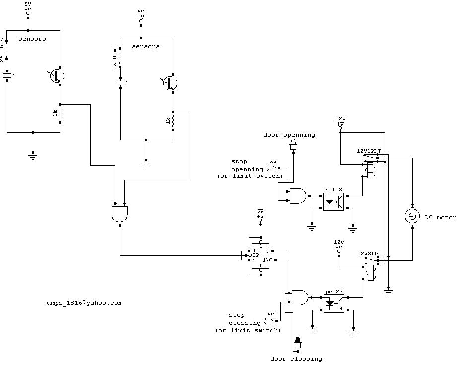

hey mates, check my shema for sliding door...for any comments and concers are very welcome...also suggestions for simplifying this circuit....

Remember that with the optoisolator, the forward current needs to be limited to 50mA, by a series resistor. The typical forward voltage of the optoisolator input is 1.2V.
If your 5V and 12V sources share a common ground, then the optoisolator is not necessary. Use a regular NPN transistor instead (don't forget the base resistor).
