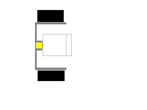

Placing the motor in the wheel is not often done as it adds to the unsprung mass of the system ( if your bot is lucky enough to have suspension otherwise it dont matter)
In your case a quick redesign is needed..
Keep the motor body and encoder stationary and
couple the rotor shaft to wheel rim :wink:

My drawings are awfull I must admit ,
Have a look at these links...
Sadly both these applications use specialist motors but the principle is the same and can be implemented with any motor, the motor body is stationary (bolted to the suspension or directly to the chassis of the robot) and the rim carrying the tyre turns around the oustside of the motor.
