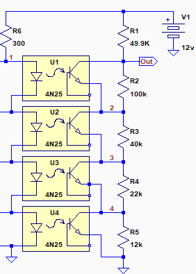

Hi everyone,
I've been trying to work out how to do something which *should* be easy, but is foxing me and I was wondering if you could give me a little guidance please?
I capture rainwater from my roof and store it in a water butt for garden irrigation. The tap is quite near the bottom so as to maximise the water I can take out of the butt. Every so often (about every 6 months) water suddenly stops coming out because silt and muck from the roof has risen up above the level of the tap. The problem is, I use this water for automatic irrigation and I don't have a sensor for saying that the water isn't running.
I decided a better way might be to have a number of sensors to monitor the build up of silt in the bottom of the butt so I started thinking about building a short length of pipe with maybe 4 slotted opto-switches on it so that and potting the whole lot. Then, I could put that length of pipe down to the bottom of the butt and as the silt rises, so it will cover each of the opto-switches in turn. I could use this to work out what level the silt was.
I've got a device which I've played with before that is a datalogger with a 10V range and a single analogue input. It also has the capability to uplink data (I've not done much with this right now) but I was trying to work out if there was a way to encode the output from the individual opto-switches (probably using some appropriately sized resistors) that would mean I could inspect voltage and decode which of the switches were covered. In my mind, if each resistor connected to the output of each opto-switch was half the resistance of the previous, I should be able to get a voltage that I can decode back into which on is on or off.... but I am struggling!
Any help or guidance or better suggestions about how to take multiple opto-sensor output and encode onto one channel would be much appreciated!
Many thanks in advance!
Neil

The opto devices I have are TT Electronics OPB800W51, and the input range in my ADC is 10V, it's a 10bit device so not massively high, but should be good enough I think...

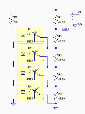

What supply voltage do you have?
You can connect all the input diodes in series with one series resistor to limit the current.
At the output you could use five resistors in series (say 50k ohm) as shown below (using a 12V supply).
The output will then have 5 distinct voltages, depending upon the number of optos that are on, with the maximum (all optos off) being 4/5 V1, and the minimum (all optos on) being about 2V (due to the on-resistance of the optos).

@crutschow that is exactly the sort of circuit that I was thinking of, but I wasn't smart enough to do! Thank you very much for your help! I will try this with some of those opto-switches and let you know how I get on!

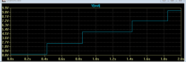

Here's the revised circuit to correct a typo, and also changed the resistor values to make the voltage steps relatively equal, as shown in the simulation graph:
