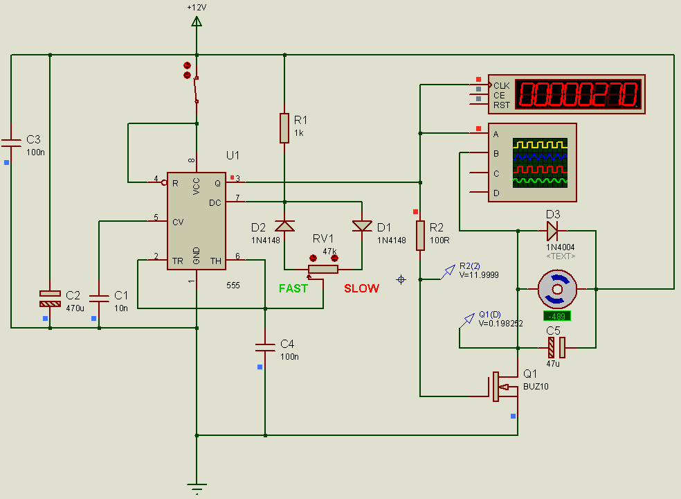

you might want to build your own circuit.
Here is a suggestion:

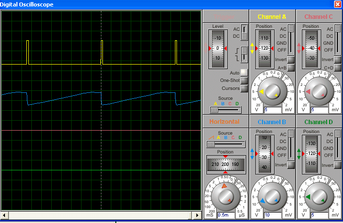

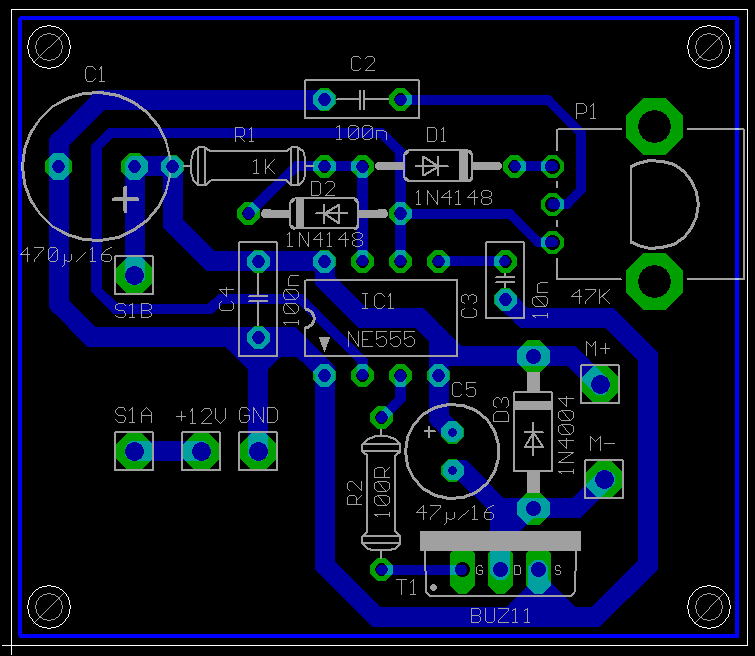

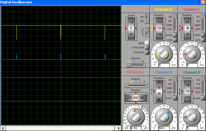

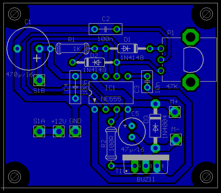

Duty cycle varies from almost zero to almost 100%. With the pot wiper at center position the duty cycle is exactly 50%.
If you don't have tools to create a PCB you might build the circuit on a strip board.
If you want to make a PCB just PM me your email address leaving your full name (for the contact list for easy relocation).
Here are some screenshots.
That circuit will last forever with a power transistor able to switch loads up to 30A.
