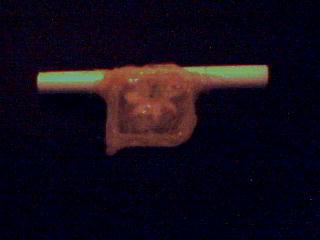

So I made one ( nothing better to do ) out of a piece of tube, two corners from the lid of a box that contained cotton buds ( Q tips ), a modified nylon gear wheel, an axel and lots of hot glue. It works fine. All it needs is an IR led one side and a photo diode on the other. Here's a dodgy picture;

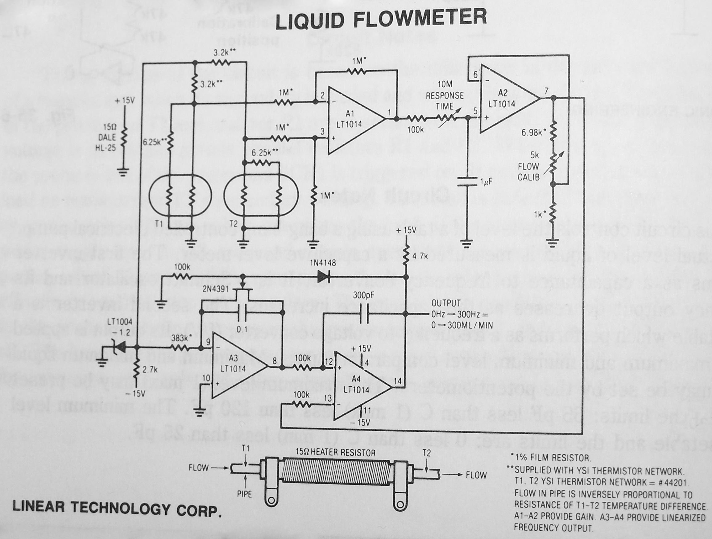

This may be useful. It may need some modification to suit your purpose, but the concept works. What do you think?
The flower sensors is only going to detect flow past the sensor not out of the nozzle. So you're going to need to add a delay anyways to wait for the air past the flow sensor to clear out. If you ask me you're over complicating things a bit. A simple delay would work fine. And a nozzle heater would work in the winter and be even simpler.
