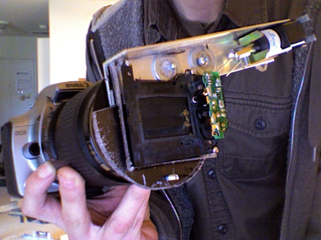

Does anyone know of (or has used) a small, fast pull-type solenoid? By fast, I mean the pin is drawn in (0.5") in <10mS.
I'm currently using
Guardian Linear Solenoid-The Electronic Goldmine
which at 36v (max rating of solenoid is unknown) draws in fully in about 20mS. Not too bad, but I'd like something even faster, <10mS. At 24v is takes about 30mS. Extrapolating to 48v presumably gives a time of 10-15mS, assuming inductive effects etc. don't hamper things terribly. I'm reluctant to go to these high voltages, because of my general lack of experience.
in case you're wondering, I'm using the solenoid to open an external camera shutter so I can photograph flying insects. Inspired by this chap,
Equipment insects in flight 2009 Photo Gallery by fotoopa at pbase.com
I'd also be interested in any other fast actuators that can pull a lever really quickly, over a linear distance of 0.5"
I also wonder if a smaller solenoid would be faster, because the inertia of the pin is smaller...
Many thanks.

Attached a picture. Solenoid to upper right. pulls a level that opens the shutter curtain.

hmm guess you really need to use the solenoid then. If it's really short you can usually send a LOT of current through a solenoid. But aside from faster you're also making it stronger, you might actually start breaking things at some point. Try gradually stepping up the voltage 5 volts at a time or so, and measure the responce increase, if it doesn't get much faster soon or the solenoid fails then you know you need a different solenoid anyways.

Yes, I might need to add rubber washers to absorb some of the impact.

You could charge a cap to a higher voltage, then dump the cap into the solenoid coil to give much faster operation.
Also the solenoid will move faster if the throw (distance the armature moves) is reduced. That gives a higher field strength and more linear force at the armature at the instant of turn on. If the throw distance is long the field starts weak and will slowly accelerate the armature, and the whole process will be much slower.

If you can design a rotary actuator into your shutter linkage, you might consider using an analog servo-motor. The advantage would be an extremely fast time constant ... can't give specifics though. These motors have a maximum torque at zero rpm ... at take-off, so to speak. They can usually take quite a few amps ... probably just a matter of dialing it in.
The control scheme might consist of pulsing the motor in one direction to open, and the opposite direction to close ... if that is how the shutter works.
You would have to come up with a functional mechanical linkage between the rotational motion of the motor and the linear motion of the shutter.
Although DC servo-motors usually require a custom power supply to accommodate proportional control, it may be possible in this case to utilize an H Bridge configuration to achieve an on-off, reversible current pulse mode.
It's hard to imagine the mechanics, but you might consider using the actuator and magnets out of a disk drive. You could easily drive it with 24 volts. See if you can work the crash stops into your mechanics.:D
Rotary solenoids are pretty quick. The only problem is if you need them to kick hard and stay open, you have to reduce to a smaller holding current. They were used as the pen lift mechanism on HP plotters. I used them for mechanical shutter actuators.
It seems like solenoids ... of whatever type ... have a restoring spring, which returns the moving pin to its original position after the control pulse has ended. This return spring opposes the electrically induced primary force. If you have any significant pin travel length, your primary actuating force will consequently decrease as you extend the pin ... Remember F=kx? ... The more the restoring spring is extended, the more the negative acting force. The decreasing actuating force will decelerate the pin, and increase its travel time.
Getting an electric motor to operate the shutter would require some time, effort, and modification to adjust the pulse strength and pin travel distance, but would ultimately produce a faster shutter speed cycle, as compared to a solenoid.
