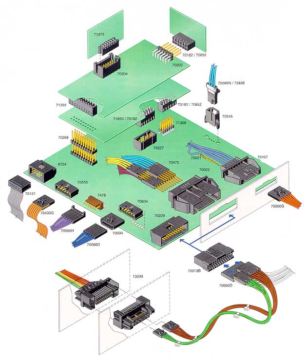

I don't know those miniature radio control connectors you are referring to but a 0.1" (2.54mm) latching type crimp connector system that I really like is made by Molex called "SL". They have all different types (see attached). You might want to give them a look. Digi-Key or Mouser has them.
