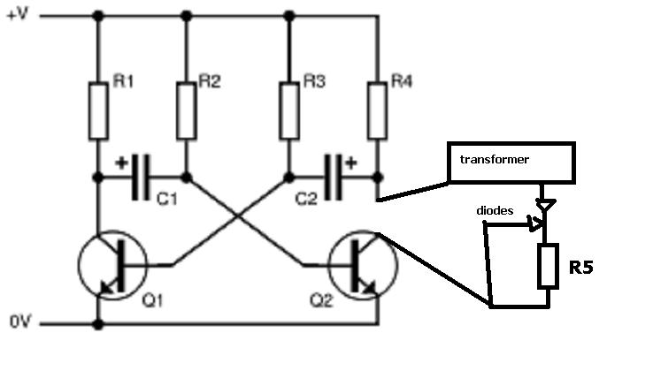

i'm using an astable circuit, the transformer is between the collector and capacitor of one of the transistors. I'm planning on using two transformers, one attach to each collector and connecting both outputs together to double the current.
Could you post a circuit diagram? I am having trouble visualizing your circuit.
sure, i'm attaching it to this post
There are no component values on the diagram. Please fill them in. I fail to see how that circuit could generate much power to the load at all. Are you sure that is how it is wired?
What you have is a flyback type of circuit. That will generate a voltage much higher than the supply voltage times the turns ratio. Basically a flyback circuit stores energy in the transformer inductance and uses the inductive kick to generate a high voltage. This occurs because you are applying pulsed dc to the transformer, not AC (the applied voltage is only one polarity). See https://en.wikipedia.org/wiki/Flyback_converter for further explanation.
To use the transformer as a normal converter you need to alternately apply equal plus and minus voltage to the primary (bridge type circuit). You can also use a center-tapped primary and alternately apply a plus voltage to each side of the winding with the center tap grounded.

Sorry but that circuit is a pretty poor way of doing it.
For a start the transformer is in the wrong place, it should replace R4 and it'll only drive it with positive pulses so it will output an asemetrical waveform which most appliances won't like.
You are trying to make this lousy inverter:
1) Its capacitors have backwards polarity and blow up.
2) Its transistors have avalanche breakdown of their emitter-base junctions and the resulting high current is in the capacitors instead of in the load.
2) The base current of the transistors is far too low for an inverter.
It might work if the capacitors have the correct polarity, the transistors are high gain darlington type and their emitters have a diode in series.

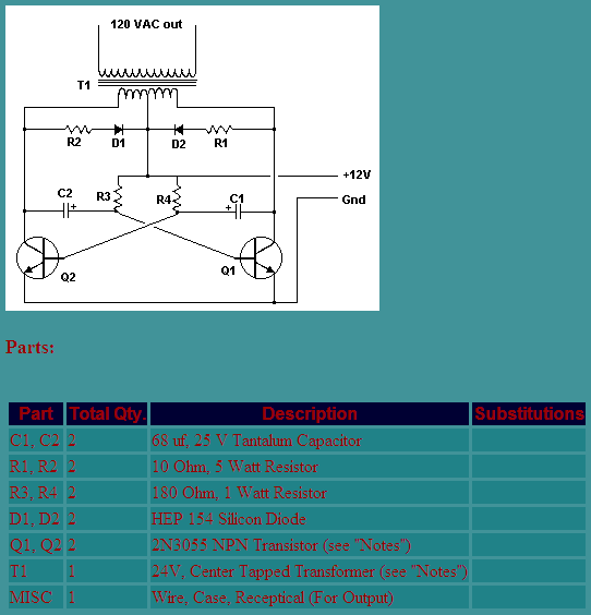

despite the drawbacks i decided to build this inverter, my question would be if i use an 18v power supply instead of a 12v, would that be ok ?
The transistors have avalanche breakdown if the supply is higher than 7V. The avalanche breakdown uses most of the inverter's power to destroy the capacitors. 18V will destroy the transistors and capacitors. The simple circuit DOES NOT WORK!
If the circuit is powered by a 6V battery then the transistors will not have avalanche breakdown. If the backwards capacitors have their polarity corrected then the very low input current to the transistors will produce an inverter with an output power of about 16W. What can you power with only 16W?
