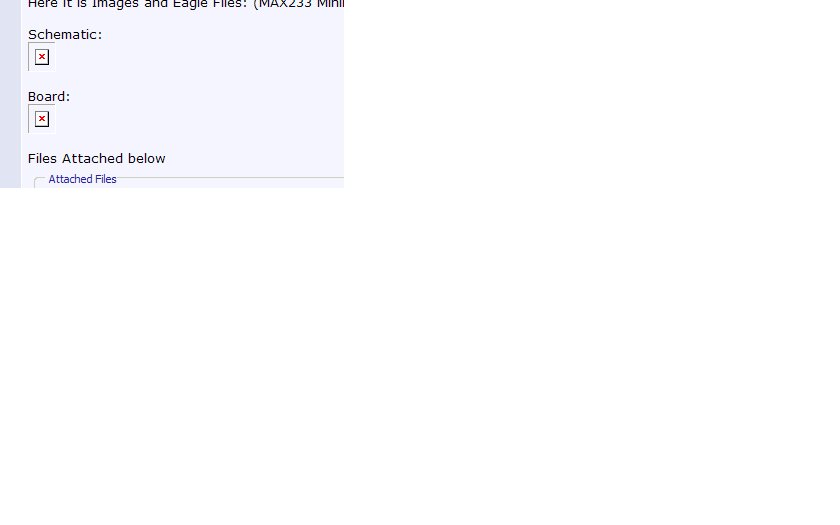

I decided to make the DB9 wired so it wont weigh down the board.
Here it is Images and Eagle Files: (MAX233 MiniBoard)
Schematic:
Board:
Files Attached below
  • Max233.zip
not sure what you mean but i see them lol Try a refresh
Did that. Then I shut off the browser and restarted it. Still no images.
Here's what it looks like. The zip file is there:
Schematic:
Board:
EDIT: Tried it in IE. Here's what I see:
