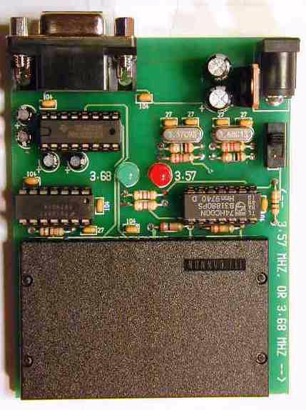

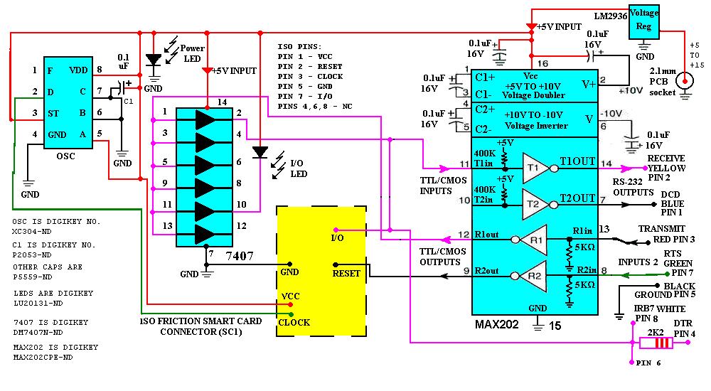

Does anyone know anyting about these things i was hoping to build one so i could write onto a card and use it as an access card for my computer!!
Any help would be great thanks !!
I have also found some schematics for some ideas if anybody has some or something similar, but they requier some parts i am not familar with if someone could give me some help from one they had it would be great thanks....
These are the schematics that i have found umm i am sorry about how they are written i didnt write them but they should be easy to follow
The picture you have posted is of a Phoenix programmer......All it will do is program a hex file into an eeprom on a gold wafer card or any of the other pic based smart cards.....You will also need a bootloader file to program the pic to enable thru pic programming when you change the eeprom contents......so you will need a pic programmer too......with a smartcard slot......I'd suggest you search for material on ISO7816 smartcards and have a read
