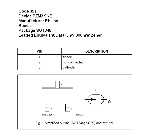

smd diode part no.391 come from power supply of sony multimedia projector.I need help for equivalent and data sheet.
