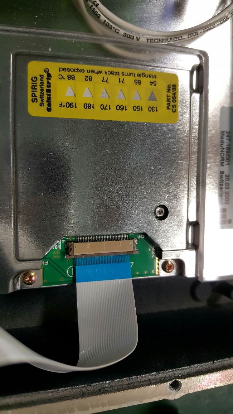

Hi guys,
do you know this type of connector? I have to find and replace it. Thanks.
It's a cable for flat flex cables. These come in many styles.
You'll need to know 3 things to find a replacement:
1. The number of conductors
2. The pitch (i.e., the spacing from centerline to centerline of adjacent conductors).
3. Whether there are conductors on both sides of the cable — usually not, but maybe?
Then search on Digikey for flat flex connectors and set the parameters in the search box.
The connector is a type of "ZIF" (Zero-Insertion-Force) connector.
