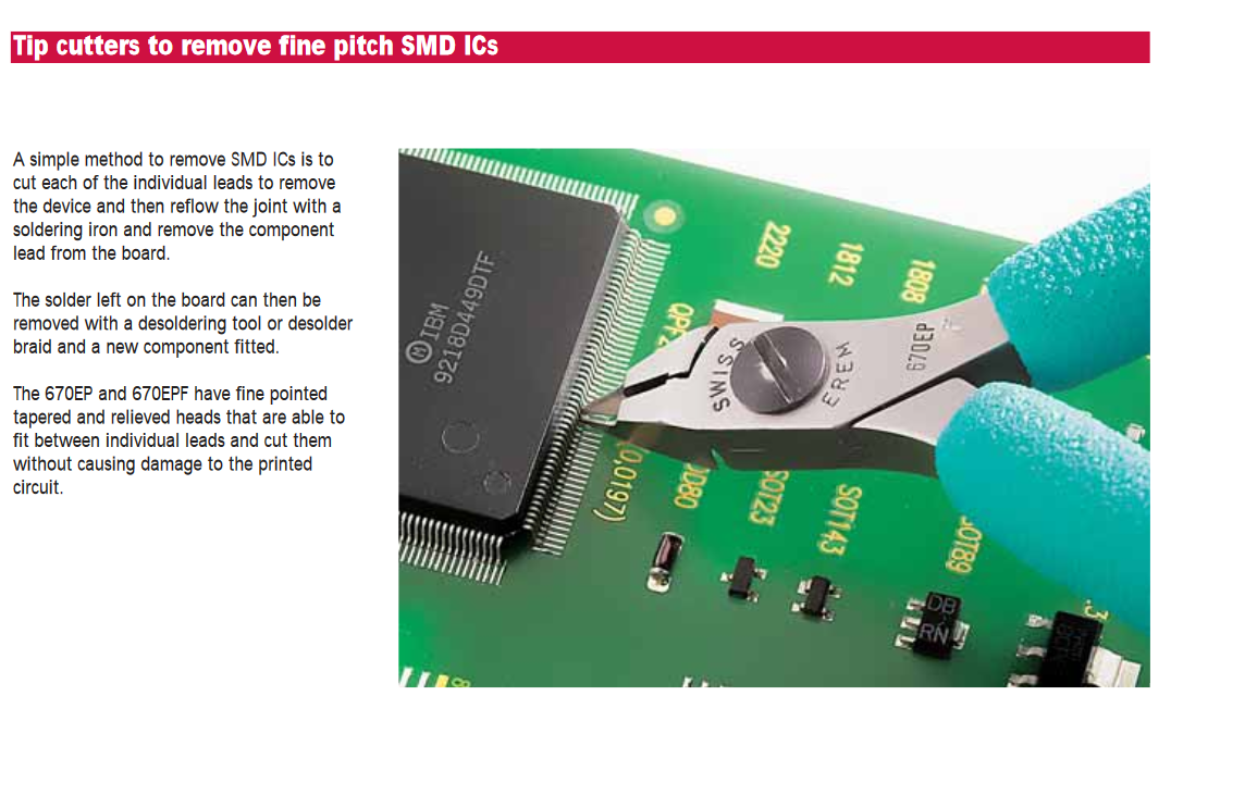

Is anyone able to confirm if the expensive tip cutters such as the Erem 670EP or 670EPF are small enough to cut individual 0.5mm pitch SMD pins on an IC?
I mean...the catalog has a picture of them doing it. I have a pair of Plato 170SMD which are no longer made and as small as they are, they still aren't able to do that so I find it a bit difficult to believe without a real human being confirming it. They are too expensive at $200 a pair for me to gamble on without knowing that.

It's been 4 years now since I retired, but I seem to remember being able to do it with a 622NB. Looks to be the same as the 670 except it is not ESD-safe and half the price.
https://www.qsource.com/m-81-erem.a...tyIDs=@(15197)@(15200)@(20822)@*Sort=5*ava=0]
The jaws between the 670 and 622 look different. The 622 looks more like the traditional angled-tapered jaws. with a cutting edge the entire length of the jaw. The 670 has relief only at the tip and the cutting jaws are only at the tip. Do you remember if it was QFPs 64+ pins you were working on?
Yes, the 622 has a cutting edge the entire length of the jaw. Yes to the QFPs. I do remember it was tough getting the first pin cut. After that there was a bit more room to get the cutter in.
