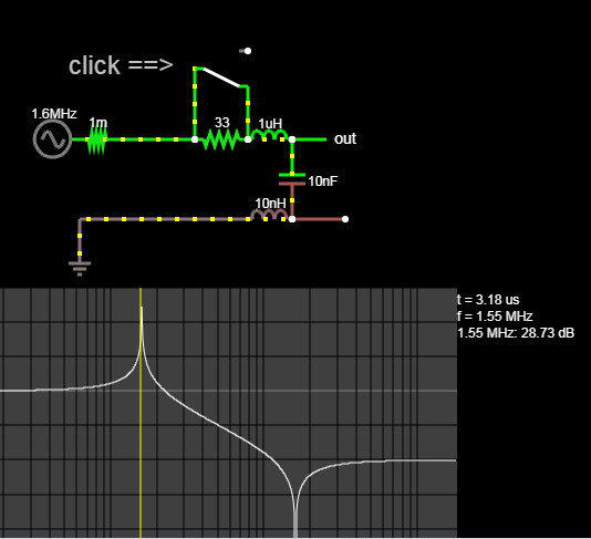

For those who have not taken Transmission Line Theory
A wire or a cable is not just a wire, it is a high frequency resonator.
Beware of high Q wire resonance effects on pulse loads and SMPS noise amplification.
interactive simulation ( change RLC etc)
Every pair of wires is actually equivalent to lumped inductor and shunt cap or maybe defined as per unit length. The "characteristic impedance" depends on the ratio of sqrt{L/C} while the resonant frequency depends on delay time with harmonics 1f, 3f, 5f, 7f .
Here is a fairly high impedance pair of wires modeled as distributed LC and the same and as the transmission line above it. It is 2.6m and has a resonance at 30 MHz, 90, 150 ,etc.
Here I attempt to demonstrate to you without adding a filter cap or RC filter but just adding a series R or load R or both, how this alone affects the high gain of resonance. This is why we call R's as damping resistors. They don't look like it but act like shock absorbers to attenuate the peaks above 0dB (unity gain)
So when you have any high frequency stimulation or load pulses with energy near these peaks, the noise is amplified. In light loads it is especially high 60 dB peaks is 1000x gain in noise. Each vertical division is 20 dB.
This picture is worth a thousand words.

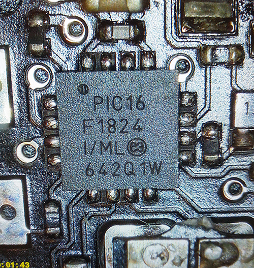

Only one was mine the others were preassembled units which contained SMD PIC MCU's
Was testing them for a friend who suspected they might be damaged. They were not.
PIC's (assuming they were actually PIC's?) are VERY tolerant of their power supply, so the PSU would have to be horrendous to cause problems.
Checked it under a scope it is indeed a PIC
