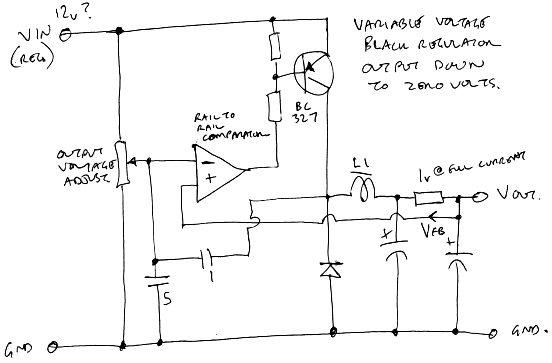

On a different tact, I was messing some time back with a 2 transistor black regulator but using a rail to rail comparator instead of the sensing transistor so it could work as a variable voltage regulator. It worked fine from 10v output, right down to zero volts output, provided a small resistor was put in the output filter to keep duty cycle above a couple of percent. Stability was also good over a pretty large current range.
I don't have my orig schematic but this is the basic format;
