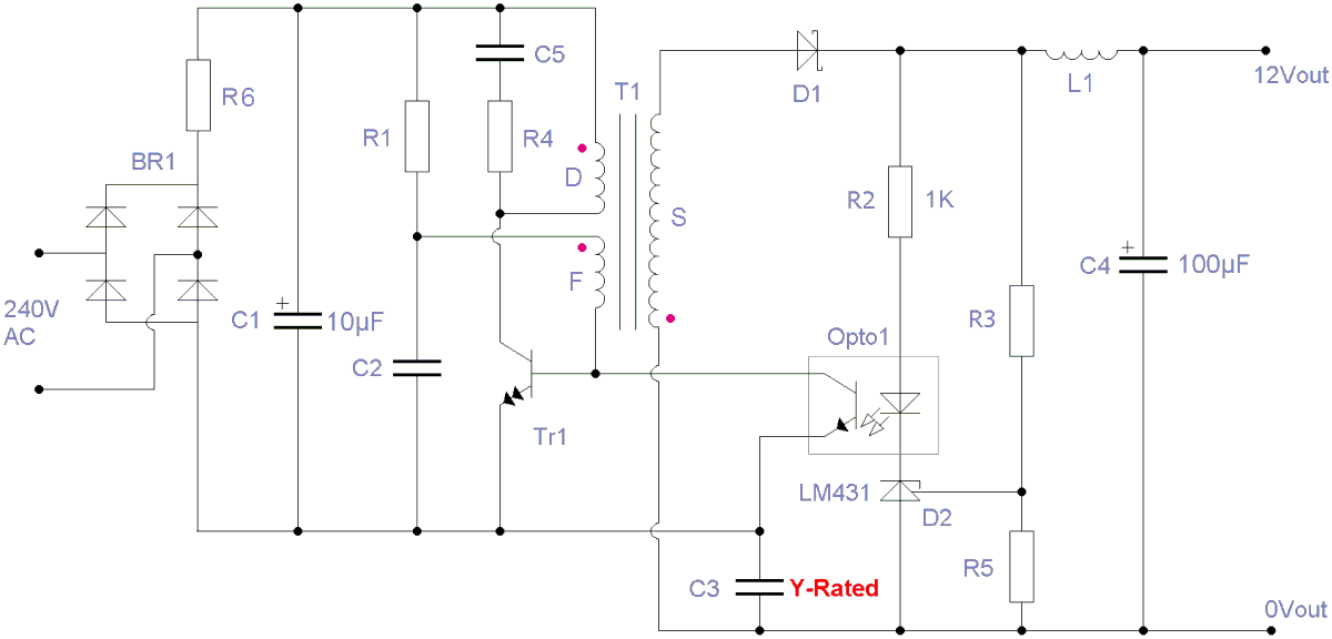

Here's an idea based around a blocking oscillator, it's probably very noisy and not very efficient but it should work.

Now please tell me (1) how the chopping frequency is ascertained and control of this frequency to achieve output regulation in case of input fluctuation ?
(2) calculations involved in ferrite transformer design at that frequency.
Again - I have seen similar design in a DVD player, so I think there must be a way to effectively filter out the noise. Please detail the components and explain the circuit you post.
Thanks.
1) The frequency will depend on the transformer and the load connected to it. As the load on the transformer is increased, the frequency will decrease.
2) Just use a ferrite with a more than a high enough power rating (always best to over-rate) for the circuit you're powering. The turns ratio, can be lower than you'd normally expect for a mains transformer because it's a flyback. Try 200 turns for the driver (D), 3 for the feedback (F) and 5 for the secondary (5). I'd recommend winding the driver, then the feed back and finally the secondary. Put a good layer of insulation tape between the feedback and the secondary. Note the phasing on the schematic.
How do you reduce the noise? You could add an inductor to the secondary side, I've edited the above schematic, see L1. The mains side should also have the a suppressor fitted.
For safety reasons C3 must be Y-rated and shouldn't be more than 5nF and if you can be certain of the polarity of the mains it's probably better to connect it to neutral. C3 helps to minimise EMI by diverting high frequency noise from the secondary side to the primary side. Its value is too low to pass enough 50/60Hz maind current to be harmful.
I've never build this circuit, it's just an idea. Always be careful when experimenting with mains voltage circuits. All creepage distances between the mains and DC side of this circuit should be >10mm. Test the circuit by connecting it in series with a 100W light bulb.

You can't use a junk circuit like that for an off line PS because it is too dangerous. You can not have a silicon path from the AC line to the output side, or you will get fried if the converter blows..... and they love to blow up, especially while you are fooling with them. You will need a half bridge converter so that the main power transformer provides AC-output isolation and you will need gate drive source crossing the isolation boundary using wither transformer drivers or opto drivers. You will need transformers properly designed for the tasks, heat sinks for the switching components and snubbers which will keep the switches in safe operating area under all load conditions. This is not trivial, I did it for about 25 years. It's not a beginner project.
OP: If you think that you may have trouble designing the SMPS you could use a all-in-one chip to do the work for you.
There is no such thing. You still have to do all the hard work. Believe me, we would have bought a chip that did the work if there was one. BTW: you can learn a lot looking at a typical off-line PS board. There is usually a dotted line showing the HV/output side boundary line. The newer ones use dedicated power IC's with the switches inside but the transformer, filter, gate drivers, opto isolators etc all have to be designed and you also have to the loop compensation which is not trivial.

Hello Hero999
(1) I have started gathering components for practical design - the transistor I'm going to use is an MJE13003 with a Ptot of 40W, a ferrite core from a salvaged CFL of 36W. But I am in great doubt about your following comment:
If frequency and load is inversely related then how the Vout regulation can be acheaved? I think frequency and voltage is directly proportional. May be I have misunderstood you - please clarify.
(2)My question was about the relation between frequency, voltage and turns.
According to you if I try with 5 turns as secondary to get an output of 12V, that means 200 turns at driver or primary have 480V. Is there really so high voltage ?! Please try to put some light on this.
Also please detail your schematic - it contains almost no component value. How should I proceed to construct?:D
