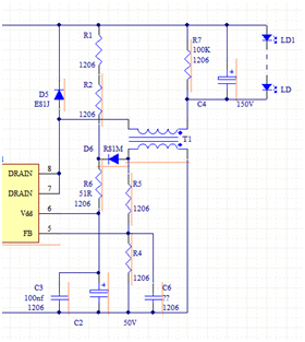

Reference Schematic of the output section.

And will the T1 (1mH primary inductance) act as a 'L' filter?
What is the current in the "switch"?
>230Vac X 1.414=325Vdc (about)
>The switch is on for 9uS and of for 8uS. (seems right for 325Vin and 150Vout buck down)
>>175V for 9uS and 1mH So 1.5A is the change in current. Well that is much higher than the 150mA. Why? Maybe PFC?
>>150V for 8uS and 1mH So 1.2A for the diode. (these are approximate)
These peak currents seem high.

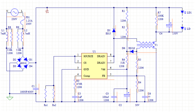

>Is the supply continuous or discontinuous?
I need to see your total schematic.
This is the complete schematic

What is U1?
Looks like PFC. So you need the LEDs during the times when 50hz is not on.
Yes, as already informed it is Active PFC circuit, so i need a calculation formula for the output capacitor value.

So lets forget the IC and most of the circuit.
We know that power is coming in at 50hz. (actually 100hz)
The PFC out puts half sign wave current at 100hz.
For simplicity lets pretend there is a full wave bridge and Cout and the load and that all.
The inductor is small at 100hz. It is large at 60khz. (not much filtering at 100hz)
You should be able to find the formula for Cout for a full wave bridge.
Cout must hold up the load for about 1/100hz. 10mS
You have a cap at +Vpeak and it discharged at 150mA to -Vpeak in 10mS, what cap value?
The cap could be a little smaller but this will get you close.
