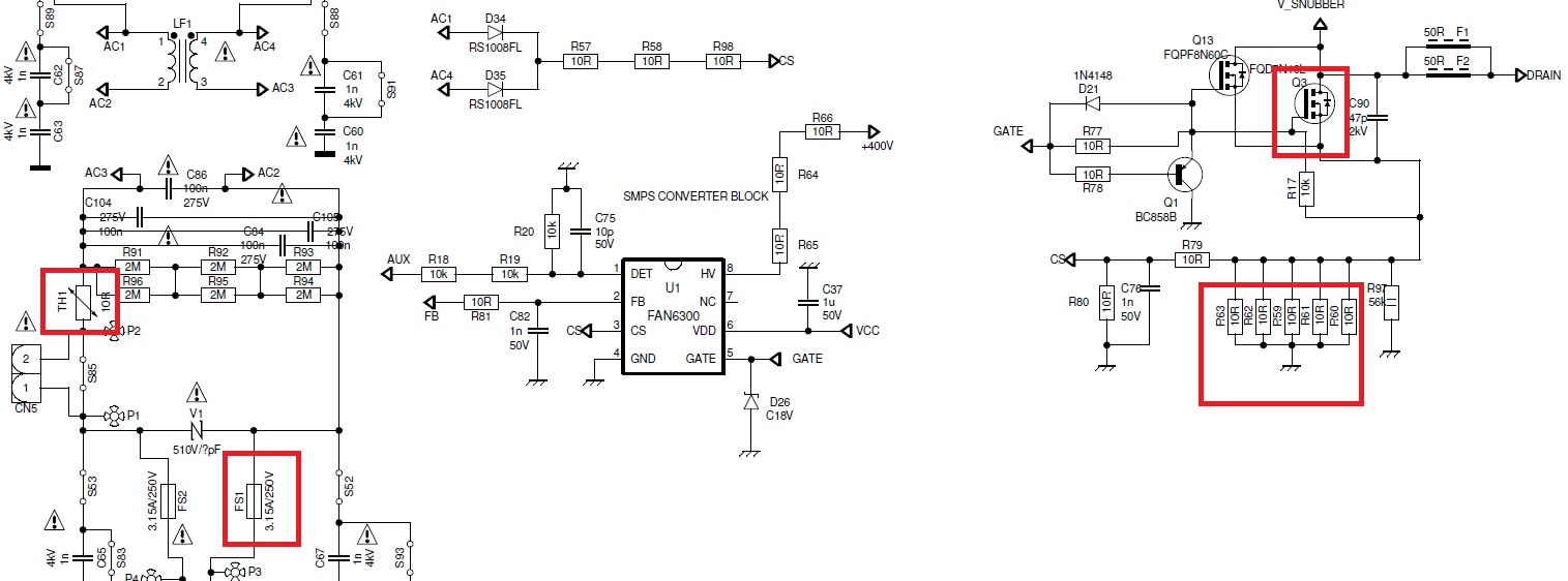

i just need a confirmation on some things so can repair a SMPS from a TV.
the components marked in red in the photo are burned. I guess first the mosfet got shorted
and then these components failed altogether. Ι can't find anything else, can i assume
only these are failed? or maybe the SMPS IC is also burned?
also i want to ask about the fuse... it's a "buss sr-5 t3.15a 250v", what can i do about it?
how can i substitude if i can't find that type of time delay fuse?
same about the thermistor it's blown, how can i subsitude if i can't find the 7S100L type?
thank you.

You just need fuse 3,15A and NTC termistor with 10R for at least 3,15A, change mosfet and current sense resistors (5x 10R atleast 3W ones) ?
3.15A A/S is a standard fuse value, and VERY common in TV's. The thermistor could be replaced with a similar device from a different TV, or even a 4.7 ohm 7W resistor, whivh is commonly used for reducing the surge.
It's likely the chip has been killed as well, I would change that, the FET's, the other bits you've identified, and check EVERYTHING else. Semiconductors in particular, diodes etc. often die when the FET's fail - in my (considerable) experience FET's are far more unreliable in TV PSU's than bi-polar transistors.
I used to assemble repair kits for the most common TV's, and change the entire kit every time one came in with a duff PSU.
One unusual failure is the reservoir capacitor, these sometimes go O/C, and while some sets work quite happily, others destroy the PSU.
Even more unusual is transforrmer failure, I've seen a few failures over the decades - presumably it's a poor design, as it's usually the same model where transformers fail.
If you don't replace all the faulty parts it will self destruct the instant you turn it on.

Nigel you are right!! there are also two shorted diodes, seems such PSUs become domino if something gets burned, i guess if two diodes failed none is trustworthy and each one of them should be replaced, unfortunately its not possible i replace every component.

I agree that the IC is probably dead too. If you want, you should be able to check it by feeding a DC voltage to its power pins and seeing if it produces an output - check the datasheet to see what conditions it needs, exactly, in order to oscillate. Even simpler would be to check continuity from the output pin to the supplies - if it looks like a near-short then it's definitely dead.
Here in the UK the FAN6300 is in stock at RS components, so it's still available - although obviously this depends on your location.
The IC connects pretty well directly to the FET's, it's unlikely not to have been killed.

...and the FET gate is shorted to drain and source!! they fail in a very destructive manner... :(
