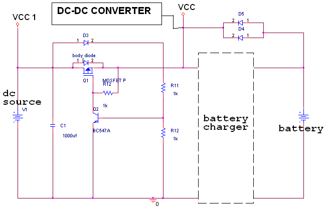

refer the circuit,,,,,task is mosfet should turn off sharply when ac is not prsent.
let me explain my requirment,,,
when AC present VCC1 will be prsent (from AC-DC converter which i mention as
DC source.)this VCC1 is the source for the battery charger and DC-DC converter
(which is connected to VCC)whether AC is present or not DC-DC converter should
be ON.,,,,,,,,
when AC-DC ON it will feed power to the dc- dc converter and charger,,,,,
when AC is absent battery should feed the power to the DC-DC converter,,,

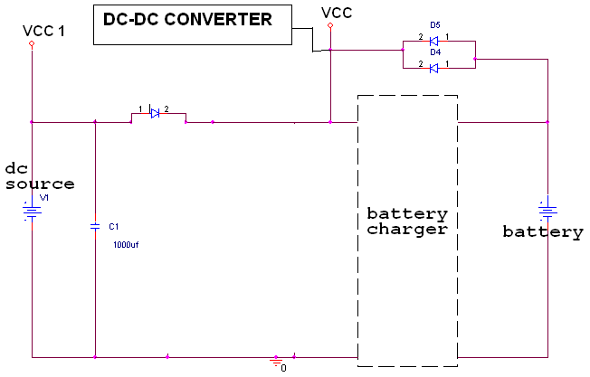

here my requirment is when AC is absent i want to isolate AC/DC from battery
(from VCC) I can achieve this with out mosfet it self ,,,,,,, i can use a diode
instead of MOSFET refer circuit 1........ but loss will be more (compare to MOSFET)
since i want to achieve much higher efficiency i want to replace the diode with a
MOSFET ,,,,,, so think in that way ....,,,,, better ideas and suggestions will be really
appreciated
