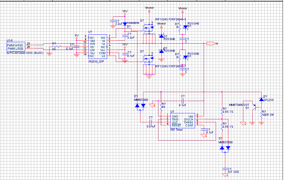

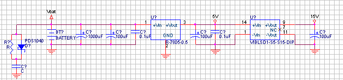

Here is a schematic of one phase for my 3-phase BLDC driver as well as the power supply. I'm thinking the snubber on the power supply is kind of really pointless because of the large capacitor as well as the snubber that already exists across each power MOSFET. Or is the big capacitor "too slow"- I'm not even sure I have to snub the voltage across the bridge when I have on across each MOSFET already. Do you see anything wrong with the snubbing here (particularily the phase-power and phase-ground snubber thing. I just kind of threw it in there. I couldn't find anything it was used in other than a flyback converter so I had to guess where it would go for something like a push-pull circuit).
Or is there supposed to be a simple R-C snubber across the motor? I thought it was supposed to be placed across the switches...or does it do the same thing regardless of where it is- controls the rate of rise of whatever it's connected across. I'm not sure if it's kind of like where the flyback diode should go across the inductive load, except it can't in an "H-bridge-like circuit" due to bidirectional currents so it is placed across the MOSFETs to form an alternate path.

Can't follow the diagram. Is it possible to add R- and C- numbers, and suppress the background grid?
Does this help? I cut out the snubber and flyback diode sections of interest.

The resistors are required to absorb the energy (damp the resonance) of the capacitor and motor inductance. A pure LC circuit would ring at higher voltages, not lower.
When hard switching on, the snubber sees the rate of rise and draws some (smaller) current. It's usually not significant and I apologize for introducing second order effects before adequately explaining the prime factors.
The snubbers across every diode are IMO overkill. A simple RC snubber across each motor winding is enough. That snubber should be enough to absorb the energy available between the cutoff of the winding power and the turn-on of the diode.
General terms of the snubber: If the winding is carrying 1A at 12V, then the resistor might be 12 ohms (limiting the basic rise to [Vcc +12V], or 24V). If the diode turn on time is 12 nS, then the RC time constant needs to be less than that. This gives a capacitance of about 1nF. If this occurs every 1us, then the resistor average power is estimated by 12W*12ns/1us, or 144mW. Substituting a slower diode increases the resistor dissipation dramatically.
A snubber on the Vbat is counter productive. Better to have a low ESR ceramic directly across the 1000uF electrolytic.

The RC snubbers across all the 3 motor terminals wouldn't dampen ringing would it? It's too far away from the FETs? It would be nice to get rid of those extra diodes- they cost $1.50 a pop! I'm at like $30 worth of diodes so far.
I can see how pure capacitance would form an LC oscillator with the circuit inductance, but what about the giant pure capacitance across the battery?

RC snubbers across all the 3 motor windings dampens the ringing, since the motor is the source of most of the stored energy. The FETs are only switching, and the stored energy related to that lies only in the inductance of the lines from the FETs to the winding.
The consequence of letting the RC snubber time constant be too fast, is more switching voltage and the resultant emissions. Not a big deal if your MOSFETs are derated and/or you don't have to deal with FCC testing.
The giant 'pure' capacitance across the battery (and the effective capacitance of the battery itself) aren't pure. The reactance is normally so low that circuit resistance provides critical or better damping.
SOoo much empiricalness! My MOSFETs right now are 40V, but the maximum battery is 21.5V (technically, I am using 25V as for calculations) voltage. Better make some rooms on the pads...I think I'll just leave space for the RCD snubbers across each FET and RC snubbers across the motors...I'm a bit paranoid.
