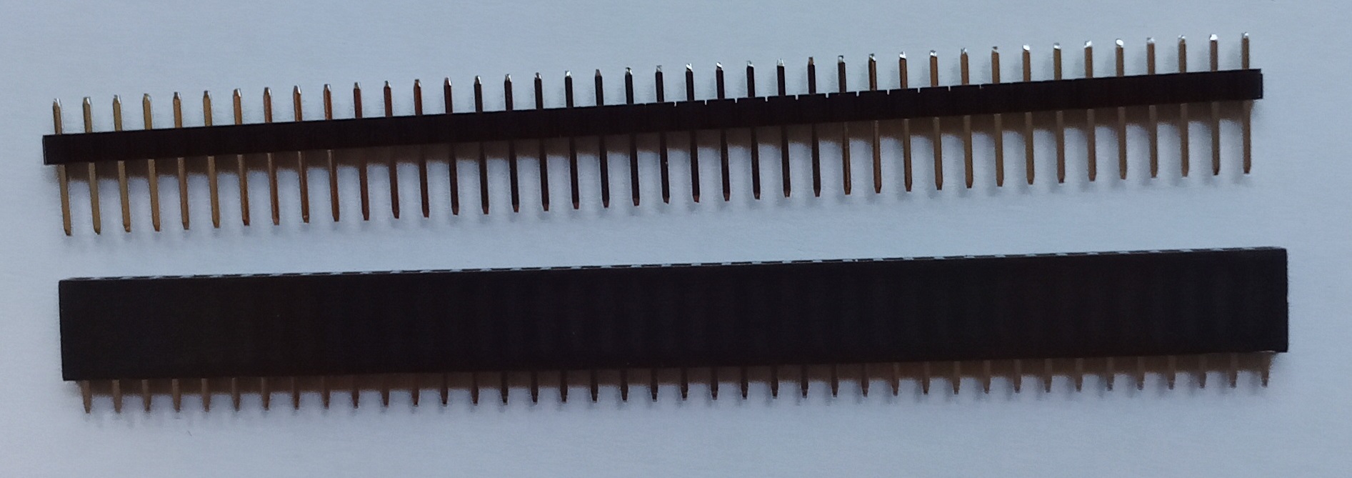

I would like to socket an Arduino Pro Mini and have it be low profile.
All I have are headers with long pins.
Should I use these and what are the mates for it?
Do you know the part numbers?
Those are for small pins such as ICs, or special turned-pin headers - they will not take standard square pins.
If you have a board that does not yet have the pins fitted, you could use the matching pin strips in it, such as Harwin D01 series.
The larger diameter end fits the PCB, the smaller pins fit the socket strips:
Or another cheaper option is put normal square pin strips in from the top of the board, so the insulator is above rather than below. That will reduce the height while allowing you to use normal cheaper socket strips.

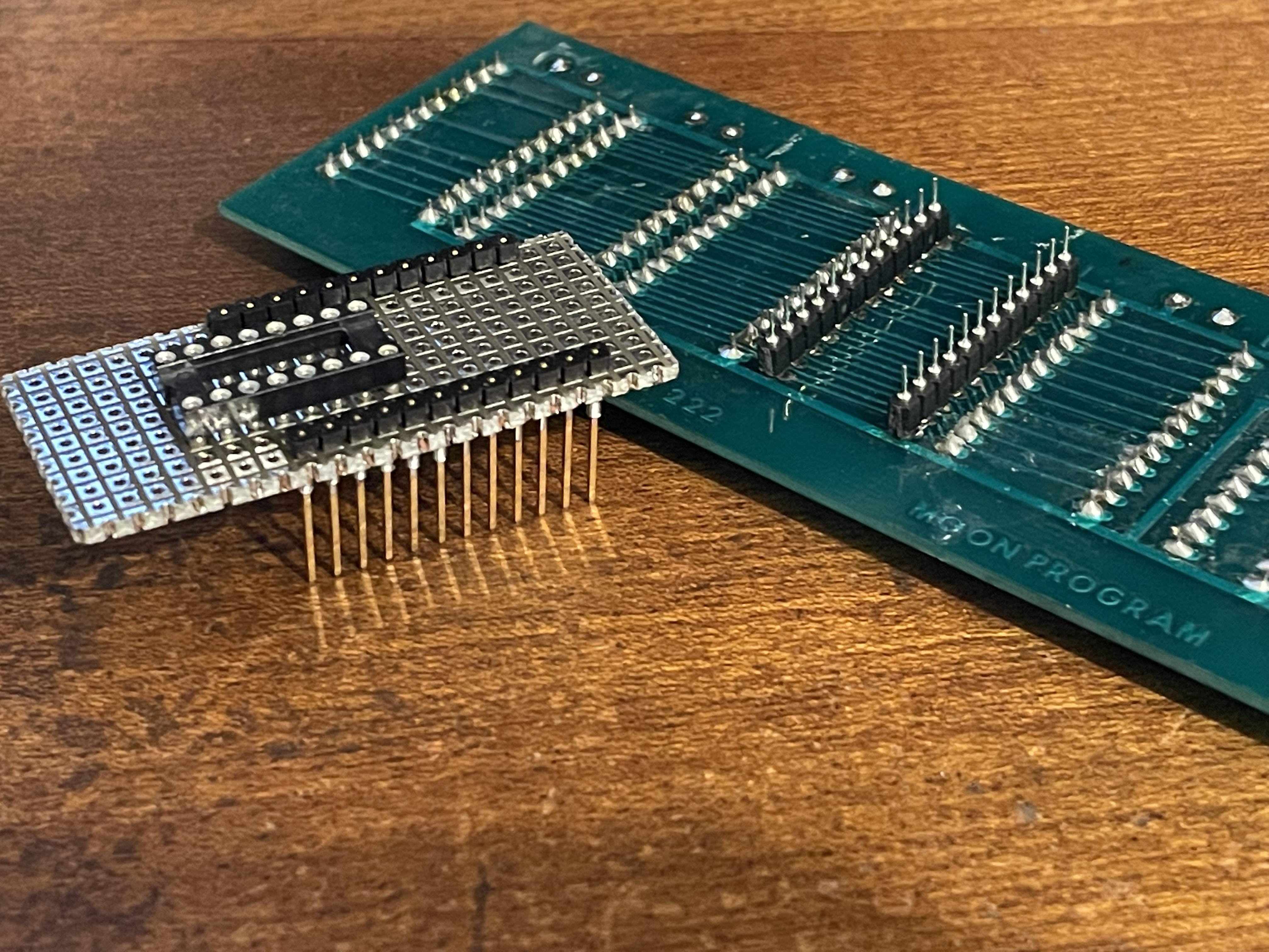

You can also just push the pins through the insulating support one at a time, to get whatever length you need; eg. I did that on this little adapter & also with the insulator on top, as I wanted it to fit a ZIF socket on an eprom programmer & also be able to use wire wrap on the underside for links to the small socket.
The green board has some of the turned pin headers, to fit a similar socket strip to what's in your photo.

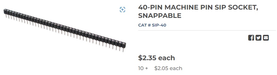

It seems that these may be my only solution. They are a bit costly. I wonder if using wires for pins may work.
Are there other choices besides Harwin?
Also I can not locate sockets for these on DigiKey.
Try these?
I can't find any different make for the headers on digikey..
