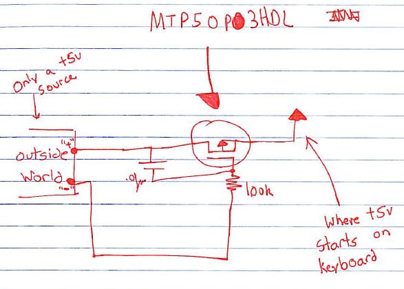

Hello,
I'd like to design a soft start circuit for a keyboard which runs by a +5V source. The keyboard will consume between 100mA to 300mA depending on if back lighting is enabled from the +5V source.
When plugging in our keyboard to power I would like to limit the inrush current so the circuit(keyboard) gets powered gradually. I have made a quick PFET version of what I think may work. At least I think it might. Attached is my schematic.
How would I test this circuit to see if it works? Are my values in the ballpark? Or is this a bad design? I can simulate with multisim but am unsure how practical it is.

That won't work. The FET is configured as a source follower, so you will only get 3 or 4 volts on the output. If you swap source and drain, you will get some turn-on delay, but due to the gain of the MOSFET, you will still get pretty fast risetimes unless you increase the time constant dramatically. What risetime are you looking for?
I designed a circuit that will give you a linear ramp for the output voltage, but it requires an additional NPN and PNP.

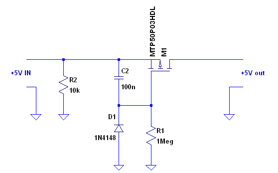

Well, I had a circuit that worked well in simulation until I added a large-value capacitor (10-100uF) across the load. This is typical of an actual keyboard load, and unfortunately, the circuit oscillated.
If you can live with a few milliseconds risetime, and a few tens of milliseconds of delay, then the attached circuit should work. As you probably know, you can tweak the times by changing the cap and resistor values.

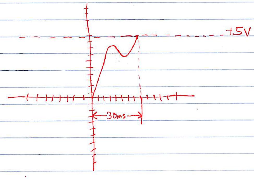

Hi Ron,
Well your circuit does indeed work! I made a quick breadboard of it and see that with the values you have shown it takes about 30ms for a full +5V to appear on the drain. Attached is a sketch out the output.(drain output)
So first I will admit that I"m an EE and forget exactly how to figure out time constants and such. For my own knowledge how would I adjust R2 and C2 to get a longer time delay.(the RC network) Would R1 play a role at all either? It looks like I would want to increase the value of C2 to get a longer time delay but am not sure. t=RC. So would the current time delay be t = rc = 10000 * .1uF = .001?
Also what role does D1 play? Is it blocking current so none goes down D1 and R1?

The time constant I posted is 0.1uF*1MegΩ, which is a 100millisecond time constant. The delay and risetimes are not easily calculated, because the gate voltage has to reach its threshold before the FET begins to turn on, but then the voltage gain causes the FET to turn completely on during a small percentage of the remaining gate exponential waveform.
Attached are the gate and output voltage waveforms from a simulation of the circuit I posted. Note the ≈55mS delay before turn-on begins, and the ≈17mS risetime. I don't know why you got the nonmonotonic rise in the output voltage. It looks like stray inductance, or internal inductance in the keyboard.
If you increase the capacitance, the delay and the risetime should both increase proportionally.
The diode and the 10k resistor combine to discharge the cap rapidly when the supply is unplugged, so that it will be ready for being plugged back in immediately.

Wow. Very helpfull. Thanks. I like the addition of the diode and resistor you added. I will be adding that to my design. I didn't think about being able to plug back in immediately. I do that with any electronics I own so I guess it makes sense to design products which are capable of doing it :)
I figured out why my output wasn't monotonic. The keyboard wasn't actually powered up because the +5V wire connecting up to my keyboard was open.(bad crimp!) So, the drain was left open. Which I'm not 100% sure why but any open pins can do weird things. I made a new cable and now I see exactly what your graphs says on my scope. I then tweaked it to a 1uF cap which gave me a 100ms rise time so I now know things are making sense.
For the 17ms the gate voltage levels out then once the FET is completely on(+5V at drain) it then continues on being more of a decaying exponential. Is there a reason for this?
When the FET starts to turn on you get the Miller effect (Miller effect - Wikipedia, the free encyclopedia) which multiplies the gate-drain capacitance (which is large for a power MOSFET) by the transistor gain. Once the transistor is turned completely on there is no more Miller effect.

My bad. A source follower would have the resistor from gate to +5V, and the cap from gate to ground. Your only problem is that you have source and drain swapped, so the intrinsic body diode is passing current to the output as soon as you plug it in. Since MOSFETs are otherwise symmetrical (except for the body diode), the output immediately goes to ≈4.3V, then goes on up to 5V as soon as the capacitor charges. This all assumes you have a load, either real (the keyboard) or dummy (160Ω paralleled by a large cap, like 100µF). If you don't have the load, the results will be only slightly different.
