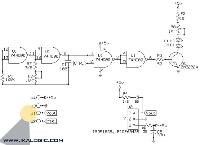

software based AMBIENT light detection
/*generating 40KHz low duty cycle pulses which will drive an Infrared transmitter. When an object is
infront of the infrared transmitter then the receiver IC will detect the object and an LED will GLOW.
i want the project to be immune to ambient light such as a desk lamp.
1)when i shine light on the transmitter i want the led to be off.
2)when there is no object infront of the transmitter i want the led to be off.
3)when there is an object infront of the transmitter i want the led to glow.
i programmed the pic16f690 and put it in my circuit. this is what happens:
1)LED pulses continuously when no object in front of it.
2)when object infront of transmitter it stops glowing
3)when shine light on transmitter the LED pulses very fast.
hardware connections:
LED connected to RC3
output of receiver connected to RC2
micro generates pulses at RA2
here is my code:

the hardware part of my circuit works. i initially used a 555timer to generate pulses and the hardware worked.
all im doin now is using a microcontroller to generate pulses instead of a 555timer. so the problem lies in the software.
please do assist me to correct my code. it is for a project Im a beginner with the pic*/
