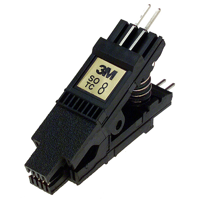

I would like to use some 12f629 in the 8-soic size chips. Can anyone recommend a cheap socket or holder for these little beasts for programming?
I don't know about cheap, but these folks always have what I need.
try digi-key
part no. 923650-08-ND

Ack. ~$90-$100 for the AS-08-08-03S-3YAM which seems to be their recommendation for the PIC12x series.
I try to use "ISP" whenever possible to avoid having to handle programmed/unprogrammed parts - although I don't know how difficult it is to setup for the part in question.
I have programmed the 8-pin SOIC parts in the past with a much more homebrew method: I etched a small PCB with an ICSP connector, and a set of pads for an 8-pin SOIC, and then when I need to program one I carefully set it in place on the pads, and use a small spring clamp or clothes pin to hold it in place (and apply pressure to make good contact). it doesn't work as well with larger PICs (such as the ones with 20 or more pins) because you're more likely to have contact issues with that many pins, but with only 8 pins it's not really a problem.
It's not fancy, but it works! (and obviously it's only helpful for programming initially, won't help you once you solder the chip down to the destination board)
I did end up buying one of those clamp things bbarney posted above for ICSP without having to include the connections on the destination board, but this method worked fine for me for quite some time.
the above soic clip that bbarney suggested is really great. though he showed a 4 pin one, you can get 8,16, 20 and 28 pin variants. I don't bother with ICSP headers on my boards anymore, just leave enough room for the soic clip. You can also use it for clipping onto a bare chip and programming it.
