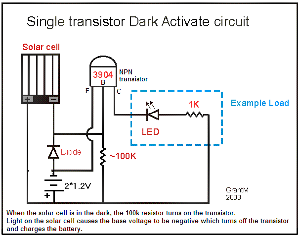

ok here is what i have. this is the diagram i have and used:
i replaced the LARGE CAP with 2 1.2volt ni-cd batteries.
the LED is a 3v blinking led from RadioShack
my problem is the 100K resistor should turn off the LED when the light in the room is on.
the solar panel I'm using puts out about 1.4v in average room light and 2.34 in sunlight. the higher the resistor the darker it should be for the LED to turn on correct? i even had 2 10m resisters in series and the only way i could get it to shut the light off is direct sunlight or my 2million candle powered flash/spot light.
it seems the led is always flashing unless direct sunlight hits it. what resistor should i use? higher? lower? i'm lost.

:) hi,
As 'agu' points out, its running from the battery.
Ive redrawn your circuit with battery in place of the cap, its clear whats
happening.
EDITED: Bty polarity! [agu :) ]
Hi Eric,
I think your battery is backwards.

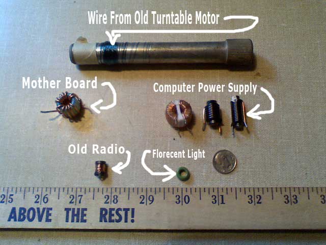

ok having a hard time finding cheap ferrites. any hints or places to buy? is there another way to build something like this without ferrites? transistors maybe?
You can quite often find these small ferrites on old pcbs, usually slid over the ends of components as noise suppression.
In the psu area of a S/H piece of equipment is a good place to start looking.
Transistors will not get the job done on their own.
Where are you posting from?
Ok here is what i found. i have some old computers all around so i ripped some junk apart.
Picture attatched.
Use a little ferrite bead or anything other than that crappy flooring nail inductor which will give poor efficiency due to the eddy and hysteresis losses.

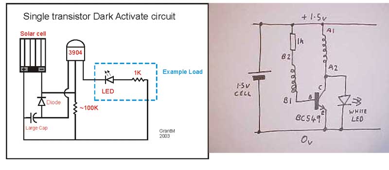

ok i got what I'm looking for now. but how would i put these two circuits together so the LED AND the solar work right.

i have my ferrite wrapped like in :**broken link removed**

ok call me an idiot. i built this one here:
was working GREAT. then what do i do? forgot the battery was hooked up and grabbed the LED leads to bend and get to fit in my 35mm canister. Then the LED was REALLY dim. took it out and replaced it. nothing now. replaced the transistor and metered the resistor. all good. the only thing i can think of is the ferrite. could i have burnt it out? i'm only getting 1.5 volts at the LED leads. man i hope i did not burn it out. that was a mother to wrap. had to do it 3 times. about 30 minutes each time. please leave me some input. i'm off to bed.

Nice to see you are a component scrounger/recycler,;) its suprising what you can find on old electronic items.
It sounds as though the circuit is not oscillating, that could be due to a number of causes..
You have changed the LED and transistor correctly and with the same type???
It maybe a shorted turn on the ferrite, check the windings for contact with ferrite ring.. dont worry about burning out the ferrite, its not going to happen.
Is the ferrite cracked across its annulus?
Do you have a dry joint on the winding due to the enamel coating?
Lets know what you find.
BTW,, S/H is second hand and PSU is power supply unit, its an easy way to write, bit like BTW!
EDIT: can you post some data for the solar cell you are using? .. Volts/mA etc
