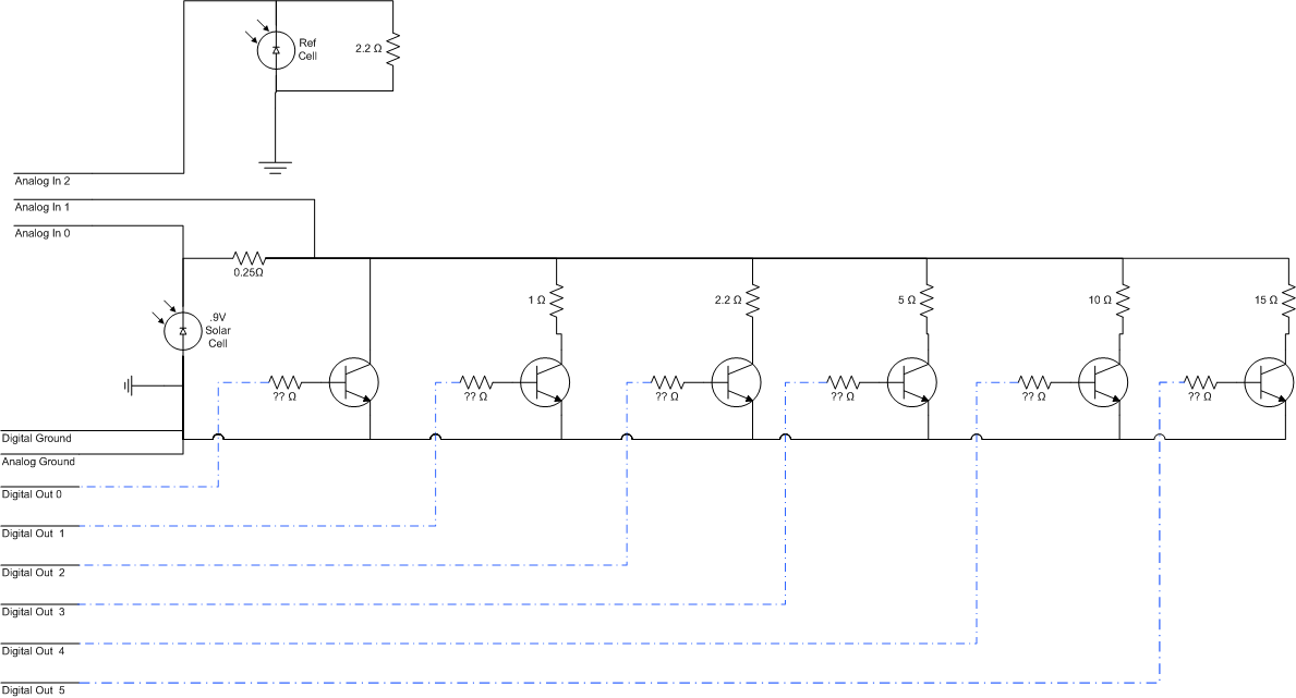

I am a building a solar cell test station that will automatically generate an IV curve of a single solar Cell. I plan on using a circuit to choose among 5 resistors to generate an IV plot. I am only showing one resistor for simplicity. I will also record Isc and Voc. I need help choosing a transistor that will not significantly affect the measurement. If not possible than I will use the transistors to power a mechanical relay. This is a low budget project so ultimate accuracy is not essential.The data acquisition device is a 12 bit minidaq (MiniDaq A/D and I/O board for the IBM PC)

My primary question is if I can use the transistor as switch without significantly affecting the measurements. I have never used a transistor before. my background is in mechanical engineering.

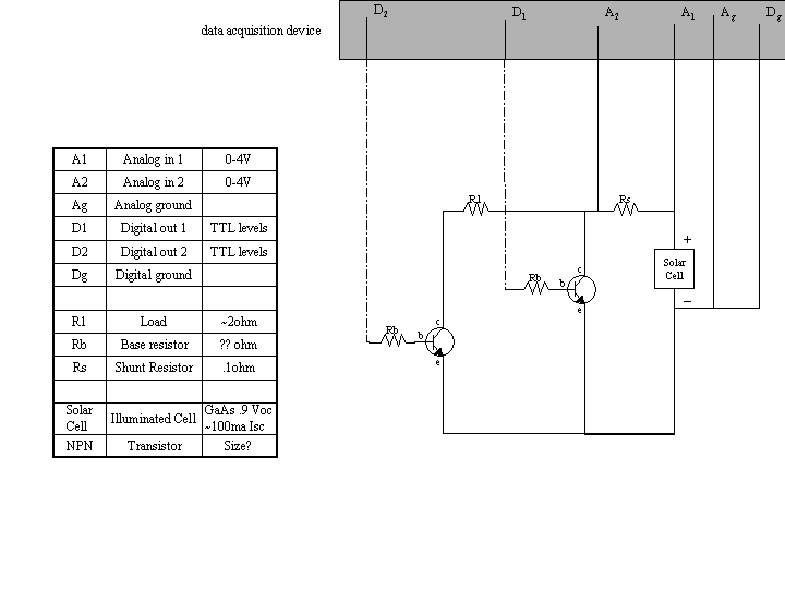

I uploaded a more complee schematic.

I'm not familiar with r-2r. I plan on using 5 resistors in parallel to get a 32 different resistive loads. I don't have any powersupply for current sink. I am measuring the cells under a fixed lighting source.

My main concern is whether or not The transistor can be used as switches without affecting the voltage measured at such low voltages (.020V-.900V) and around 40-200 ma.

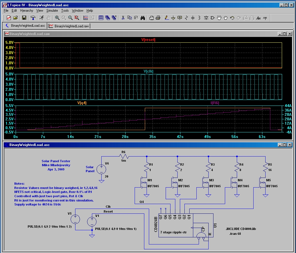

Here is my suggestion:

Sorry mike but i don't get it. How could I measure the cell performance under load if there is a 1 megaohm resistor in series. The current at 1 megaohm would be 9 micro amps. I am meauring a singe solar cell, not a panel.
That's 1 milliΩ (0.001 Ω)! It is there just so I could show the plot of I(R6), the hard to read purple trace.
Spice uses Meg for megΩ
Like Mike said note the lower case m milli vs the upper case M for mega, this is standard notation anywhere not just with LTSpice as far as I know.

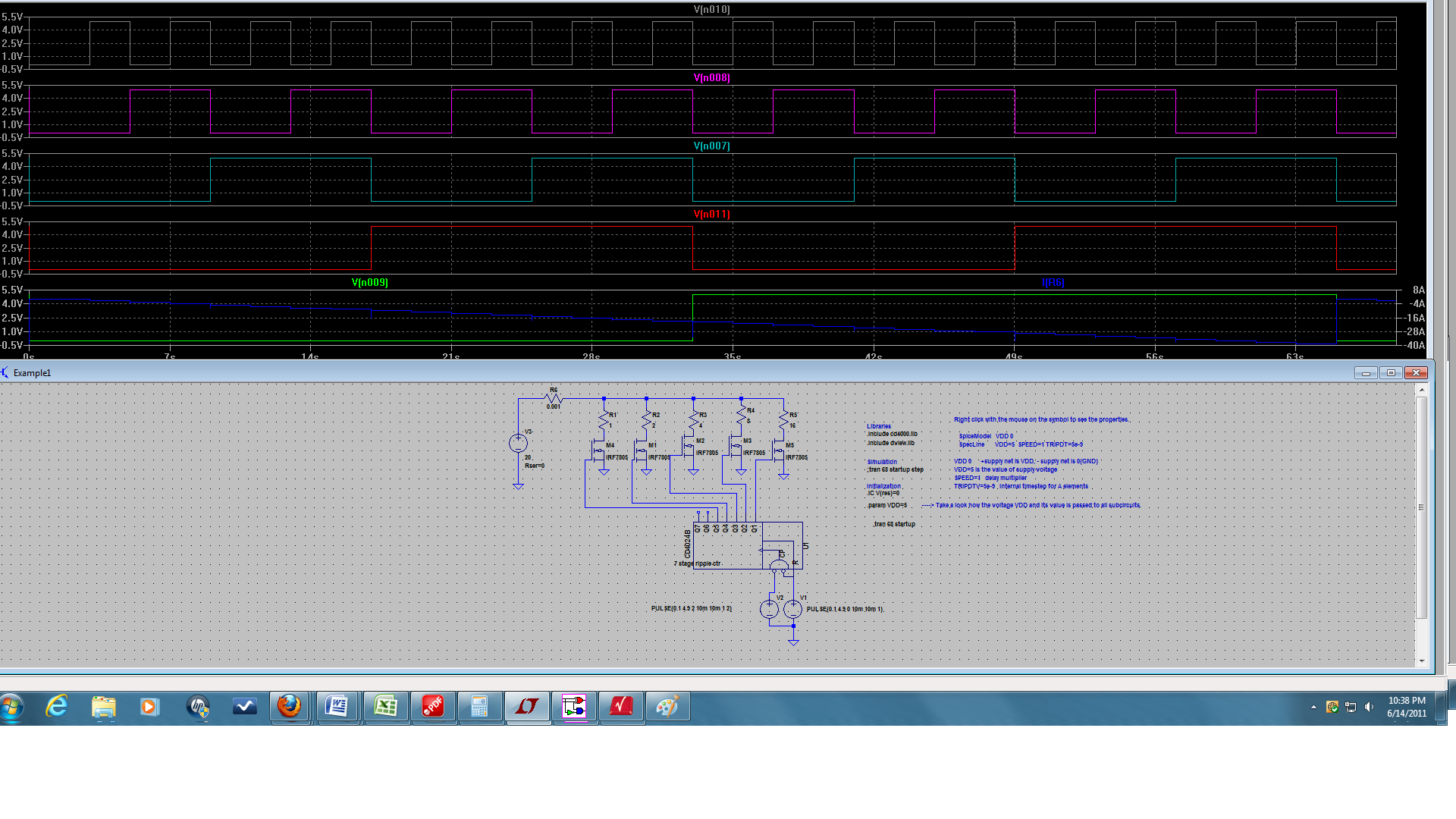

Current plot is inverted
MikeMl,
First thanks for a wonderful circuit. However, the plot/curve of current I(R6) does not match yours...It is kind of inverted for my case. What am I doing wrong? See attached for more information.

You absolutely have to have a 4-quadrant power supply, One that can source and sink current, preferably with some sort of current limit. I made one with an OP amp and 2n3904/2n3906 drivers, a few resistors and a couple diodes. You can now easily get OP amps that can source/sink 100 mA.
I would do it with a single high power n-CH MOSFET with a low value current sense resistor in source. You can make a feedback control that creates a constant current sink. The current would be set by voltage control on the feed back op amp reference voltage input. For a single cell measurement, you should be able to drag the voltage down to at least 0.1 vdc.
Scan it fast enough and you won't build up much heat in the MOSFET.
